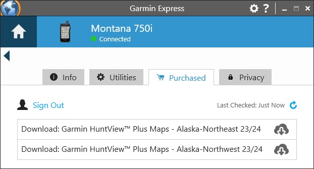

Garmin Express Purchased Tab for Montana 750i

If the map purchase is still not displayed, try the following:
  • Under the Purchased tab, click Sign Out, then click Sign In and log in to the Garmin account that you purchased the map under. If you do not have an option to sign out, remove the device from Garmin Express and then add it again and sign in to the correct Garmin Connect account when prompted. For instructions, see - Remove and Add a Device in Garmin Express.
  • Under the Purchased tab, click Blue Refresh Arrow to refresh what is displayed for purchased maps.
  • Check for updates to the Garmin Express program. For instructions, see - Updating the Garmin Express Application Software.
  • Try removing the device from the Garmin Express program, then add it again. For instructions, see - Remove and Add a Device in Garmin Express.
