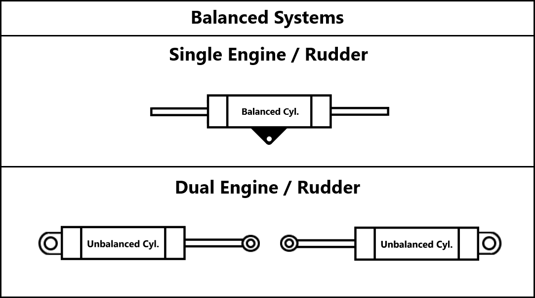

Two unbalanced cylinders can make up a balanced system if the unbalanced cylinders oppose one another. See examples below

Single engine unbalanced above dual engine unbalancedSingle engine balanced above dual engine balanced
