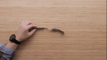

Removing a Band Link
  1. Unscrew the threaded link pin.
  2. Remove the link pin and link.
    Example
    Unscrewing the Threaded Link Pin to Remove or Add a Band Link

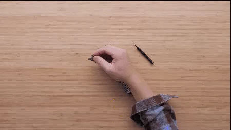

Adding or Removing a Band Link
  1. Add another link or remove one from the band
  2. Align the link pin holes so the link pin can pass all the way through.
  3. Insert the link pin.
    NOTE: Link pins are the same size throughout the band.
  4. Screw in the pin until tight.
  5. Repeat steps 1-4 if necessary.
    Example
    Inserting and Tightening the Threaded Link Pin
