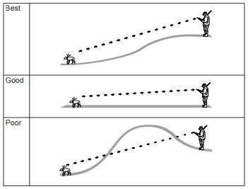

Many of our devices work off line-of-sight range and ideal weather conditions. There are many factors that will reduce the range on dog training devices. Below are factors that will effect the range on the dog training and tracking systems.
Range
Environmental Factors
Environmental factors like trees, bushes, buildings, powerlines, cell towers, Wi-Fi, and rain/humidity can affect the range of the unit. In order to get the best range in conditions that are not ideal hold the remote vertically above your head or try moving to higher ground.
