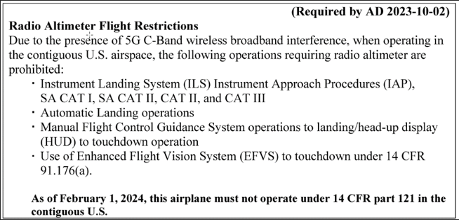

Does AD 2023-10-02 Affect my Airplane?
  • Any aircraft with a GRA 5500 or GRA 55 cannot perform certain low-visibility landing operations (shown below) at any airport unless they have upgraded to become a radio altimeter tolerant airplane. Airplanes without the appropriate upgrades will be able to operate into any airport but cannot fly the prohibited low-visibility operations.
  • The above entry must be placed in the Aircraft Flight Manual until the aircraft is modified to a radar tolerant airplane.
  • For an airplane to continue to operate under 14 CFR Part 121 on or after February 1, 2024, it must be modified to be a radio altimeter tolerant airplane.

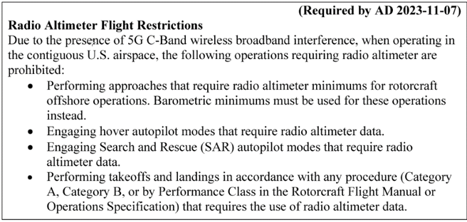

Does AD 2023-11-07 affect my Rotorcraft?
  • Any rotorcraft with a GRA 5500 or GRA 55 cannot perform certain operations (shown below) unless they have upgraded to become a radio altimeter tolerant rotorcraft. Rotorcraft without the appropriate upgrades will be able to operate but cannot fly the prohibited operations.
  • The above entry must be placed in the Rotorcraft Flight Manual until the aircraft is modified to a radar tolerant rotorcraft.
