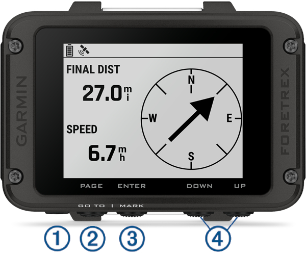

    Foretrex Button Layout
    ONE POWER
    • Hold to turn the navigator on.
    • While powered on, hold to access the power menu:
      • ENABLE NVG MODE: Select to reduce backlight intensity for compatibility with night vision goggles.
      • ENTER WATCH MODE: Select to enter a low-power mode that locks the buttons and maximizes battery life.
      • ENTER EXPEDITION MODE: Select to manually enter expedition mode and maximize battery life. In expedition mode, the navigator collects fewer GPS track points and turns off the Bluetooth connection.
      • ENTER STEALTH MODE: Select to turn off wireless communications and prevent the storage and sharing of your GPS position.
      • POWER OFF: Select to turn off the navigator.
    • Press to turn the backlight on and off.
    • Press 5 times in less than 2 seconds to activate the kill switch.
    TWO PAGE/GO TO
    • Press to scroll through the main pages in sequence.
    • Press to go back to the previous view from a menu or option.
    • Hold to navigate to a waypoint.
    THREE ENTER/MARK
    • Press to open the menu for the page.
    • Hold to mark a waypoint.
    FOUR UP/DOWN
    • Press to scroll through menus and pages.
    • Press to zoom in or out on the map page.
