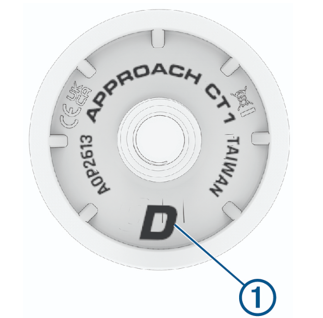

  1. Locate the tag label Number one on the underside of the tag. Your set comes with 16 tags, each labeled and programed with one of 16 club types. The tag label identifies the club type.
    Club Label on back of CT1

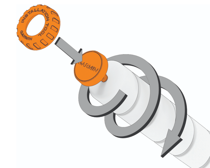

  3. Screw the tag into the hole at the end of the grip.
    TIP: You can use the installation tool included in the box to improve your hold on the tag when screwing it into the grip. Holding the tag and twisting the grip may make installation easier.
    CT1 Sensor being screwed into end of club shaft
  4. Tighten the tag so it does not move during use.

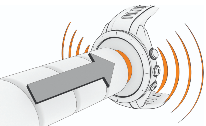

  2. Take a club out of your golf bag, and tap the tag with the watch.
