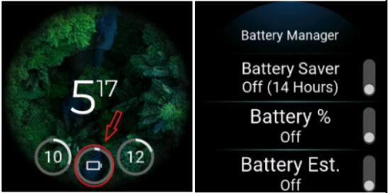

If you have setup your watch face to display the battery percentage or battery icon, you may notice that if you press and hold the touchscreen in that area, your watch will take you to the Battery Manager or Power Manager settings. If this page is accidentally activated your watch can enter battery saver on its own and disable multiple features. To prevent this from happening unknowingly you can enable Auto Lock on your watch. For details on enabling Auto Lock, see your owner's manual.
Battery Saver Settings on Watch

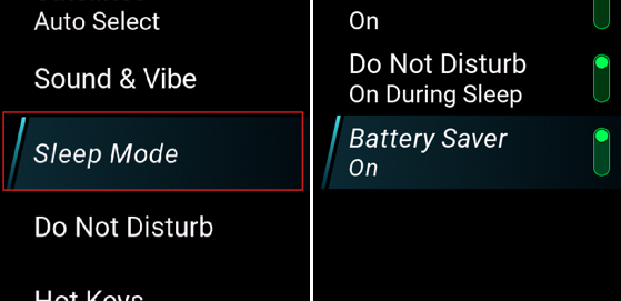

It is also possible that you've enabled Battery Saver during your Sleep window. To check this setting, see your owner's manual and search "sleep mode".
Sleep Mode Settings screenshot
