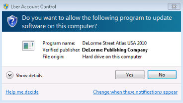

  4. Click the Uninstall button.
  5. If the User Account Control window displays, choose the Yes option.

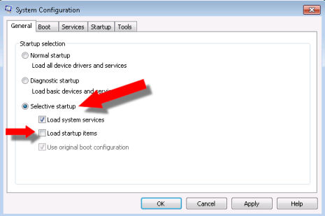

  1. Click Start , type MSCONFIG in the Search box, and then press ENTER.
  2. On the General tab of the System Configuration window, select Selective Startup.
  3. Under Selective Startup, clear the Load Startup Items check box.

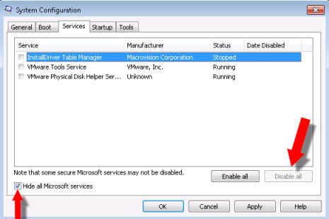

  4. Click the Services tab, select the Hide All Microsoft Services check box, and then click Disable All.
  5. Click OK, and then click Restart.

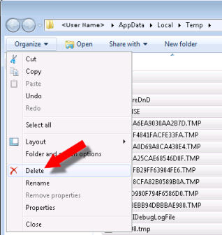

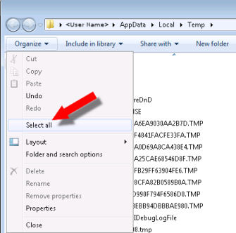

  6. On Restart, click Start , type %temp% in the Search box, and then press ENTER.
  7. On the Organize menu, click Select All.
  8. On the Organize menu, click Delete.
  9. Click Yes.

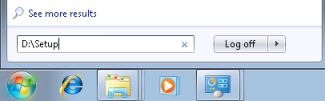

  10. Insert the DeLorme installation disc into the DVD drive. Setup begins automatically. If not, you may have your Autorun feature turned off, from the Start menu type D:\setup in the Search box (where D is the letter of the DVD drive containing the installation disc).
  11. Follow the on-screen instructions to complete the installation.

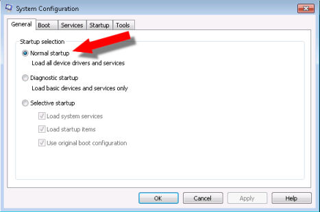

  2. Under the General tab, select Normal Startup
  3. Click OK, and then click Restart.
