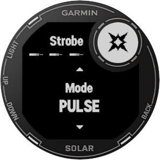

    Strobe Light Settings
    Press and hold UP/MENU, then select Strobe and choose an option:

    • Pulse - The symbols at the top of the display represent the strobe pattern behavior.
      Strobe Pulse Mode
