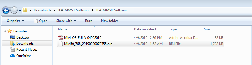

  2. Extract the files and review the included PDF license agreement (MM_OS_EULA.pdf).
  3. Save the .bin file (highlighted below) to a USB thumb drive. (Thumb drive should be empty and formatted to FAT32.)
    File Folder for JL Audio
    Note: This file should be saved to the root directory (top level) of the thumb drive (not placed in a folder).
