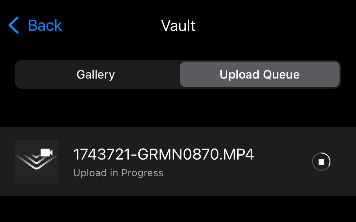

Uploading Content to the Vault
Photos and videos recorded on your Varia™ Vue or Varia™ RCT715 can be uploaded to the Vault through the Varia app. Footage is uploaded from the Gallery, and must first be downloaded and saved to your phone before it can be uploaded to the Vault. To save to the Vault, select a clip from the Downloaded tab of the Gallery, and select Add to Vault. This will start the upload and progress can be tracked in the Upload Queue. From the home screen of the Varia app:
  1. Select three blue dots stacked vertically (top right).
  2. Select Vault.
  3. Select the Upload Queue.
    Varia App Vault Upload Queue with a video upload in progress
Once the upload is complete, the footage will appear in the Gallery tab. Vault take some time to process the videos after being uploaded. During this time they will not be viewable in the Gallery. Allow the video to finish processing before viewing or sharing in the Vault.

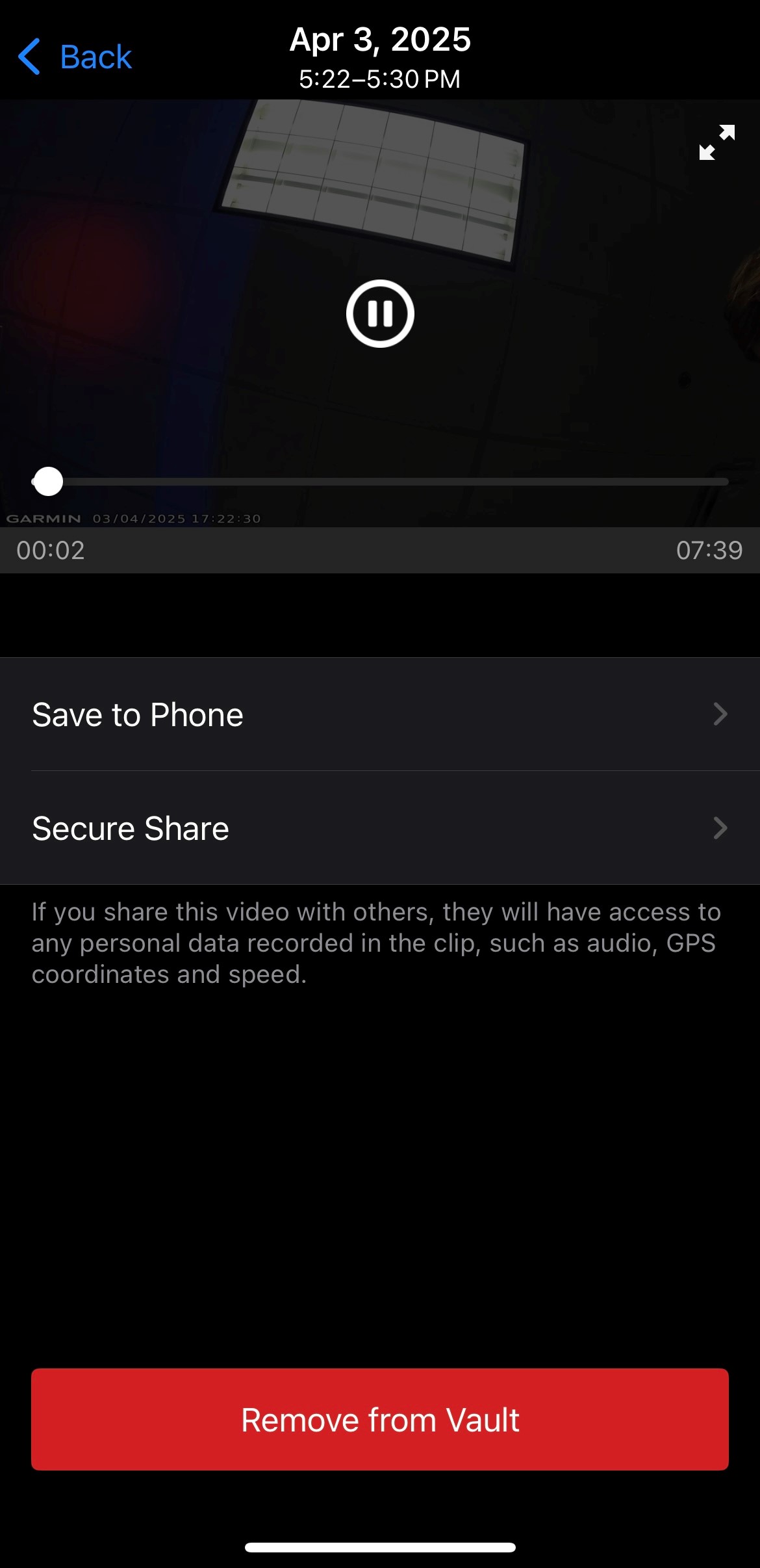

Managing Saved Content in the Vault
Content that is uploaded and saved to the Vault can be managed, shared, and deleted through the Varia app. You can view your footage uploaded to the Vault by selecting the app settings icon three blue dots stacked vertically in the top right corner, then selecting Vault. The Gallery tab will contain your saved videos and photos in the Vault. Select a clip to view the video. You will also be presented with options to save the clip to your phone, share the clip securely, or remove the video from the Vault.
Video clip saved to vault with options to save to photos, secure share, or remove from vault.
Sharing Vault Content
Your Vault subscription allows you to securely share your saved content with others. Selecting the Secure Share option will allow you to share a link to view the clip. Recipients will get a secure link to view the video on the Garmin Vault, as well as a 6 digit access code needed to view it. They will be able to download and save the video to their local storage. This link can be disabled in the Varia app by opening the clip in the Gallery, and selecting Disable Link to revoke all access.
Deleting Vault Content
Photos and videos saved to the Vault can be deleted by selecting the Remove from Vault option that is present when viewing the saved media.
