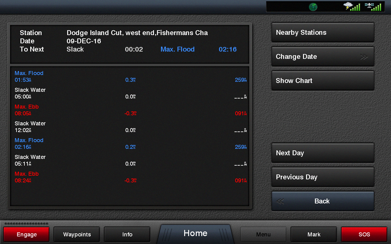

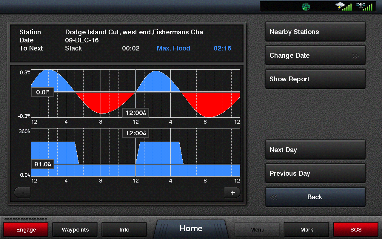

Knowing the above terms may help with reading the current charts and reports on the devices. Below are screenshots of the current chart and report pages provided by our BlueChart® g3 mapping on a marine device.
