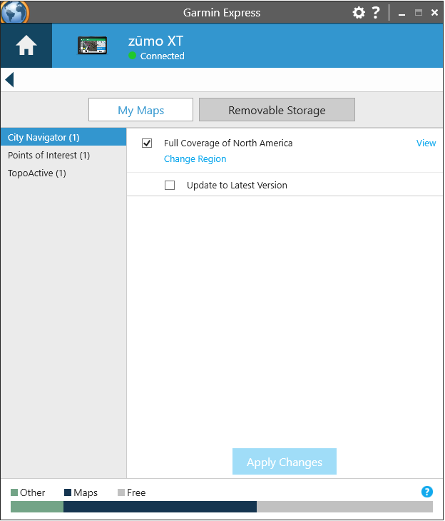

To Manage Maps in Garmin Express:
1. Open Garmin Express and select your zūmo® XT
- See How Do I Install Garmin Express? if you haven't installed Garmin Express.
- See Adding and Removing Devices in Garmin Express for instructions to add your device to Garmin Express.
2. Click Manage Maps
3. Select any map regions you want installed on your zūmo® XT
- Check marks indicate maps currently installed on your zūmo® XT.
- Click View to see the map coverage for a region.
4. Click Points of Interest or TopoActive maps to manage other types of mapping
NOTE: Do not uninstall any mapping required to remain on the device. For example, iOverlander Points of Interest are required for the device to operate. Removing City Navigator maps would make the device unable to route. See "No Detailed Maps Found That Support Routing" or "No Map Data Available" Message on a Garmin Automotive Device if you accidentally removed your City Navigator map.
- Uncheck any maps you want to remove from your zūmo® XT
- These maps can be reinstalled later.
- Some maps will have an information icon
- Some maps are required for your device to operate and cannot be removed.
- Some maps may be too large to fit on your device's internal storage.
- The bar at the bottom will show the amount of free space remaining on your zūmo® XT.
- You will see the free space decrease or increase as you as choose mapping to add or remove.
5. You can also install mapping to a memory card if your zūmo® XT is low on space
- Click the Removable Storage tab and select the option of your choice.
6. Click Move
7. Click Apply Changes once you have chosen all the mapping you want to add or remove
8. Click Continue
