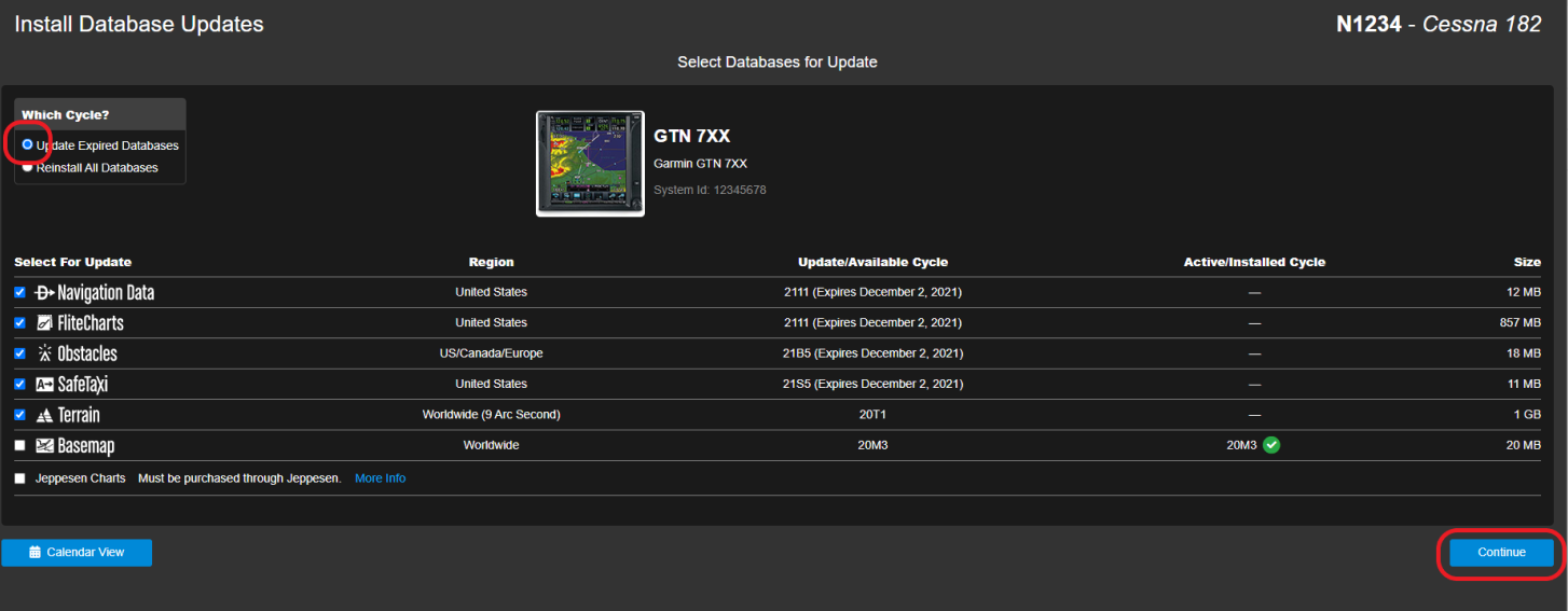

  13. Once the Garmin Aviation Database manager is opened, select the Update/Reinstall button for the aircraft.
  14. Select the devices for update, and then select Continue.
    • If you are wanting to update multiple devices in the aircraft with the GTN™ avionics SD Card, select the Sync Update option.  In this scenario, we will only be updating the GTN.
  15. Select Which Cycle and then ensure all of the databases are selected for the ones you want to update.
  16. Then select Continue.
