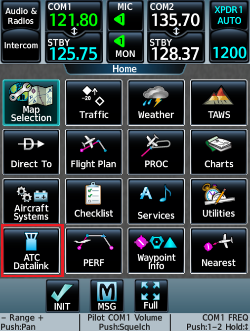

How to Access FAA Data Comm
  1. From the Home page of a Multi Function Display (MFD) GTC, Tap the ATC Datalink Icon.
    • FAA_DataComm1
