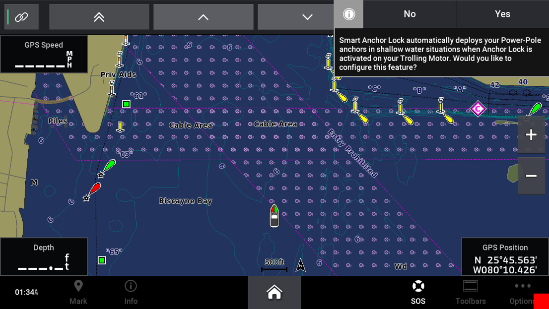

Select the Anchor icon in the top right
Select Yes to agree to configure the feature

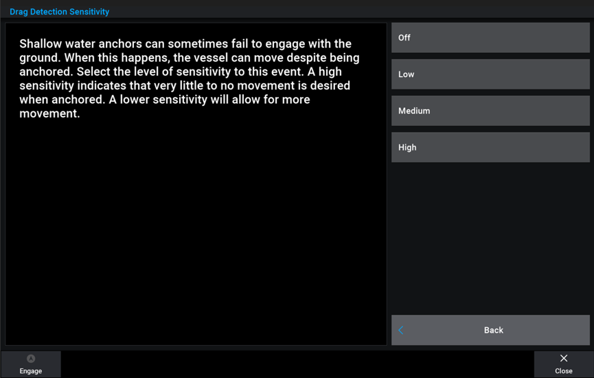

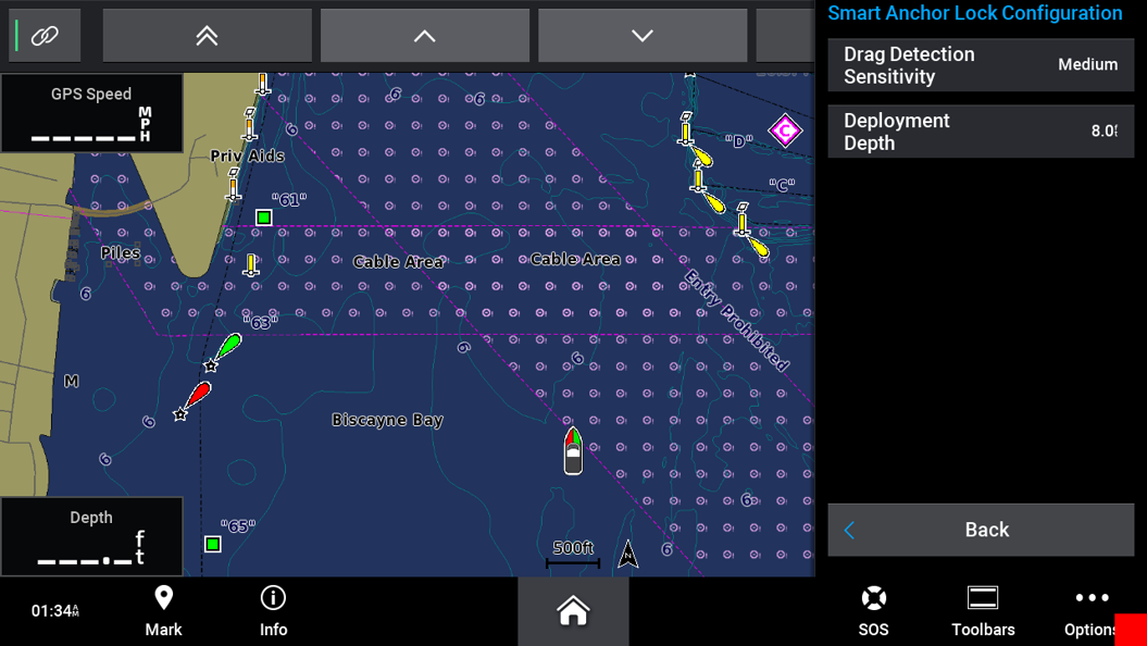

Set up Drag Detection Sensitivity and Deployment Depth
