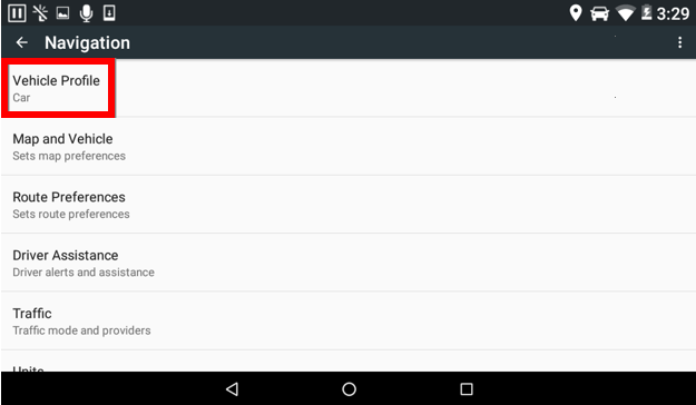

1.Touch Settings
2. Touch Navigation
3. Touch Vehicle Profile

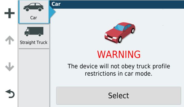

4. Select a vehicle type or touch the Plus icon for more options.
This screen can also be accessed anytime by swiping down from the top of the screen twice and touching the vehicle icon.
5. If the plus icon was selected, the vehicle can be selected here.
