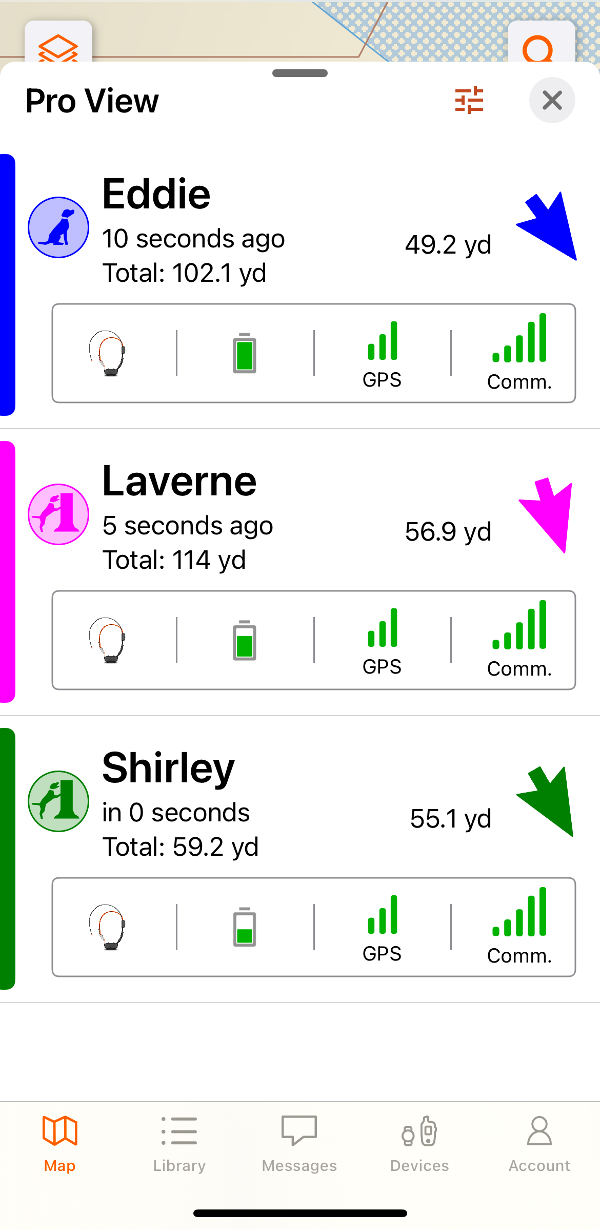

Pro View is an optional view in the Alpha® app that will display directional arrows with distance for each dog being actively tracking. There is also an option to view single or multiple dogs. This view can also provide additional information on the dog devices such as battery life, GPS signal, communication signal and LTE signal.

  3. The multi-dog display will show on the bottom half of the screen. You can scroll through the list of dogs from here.

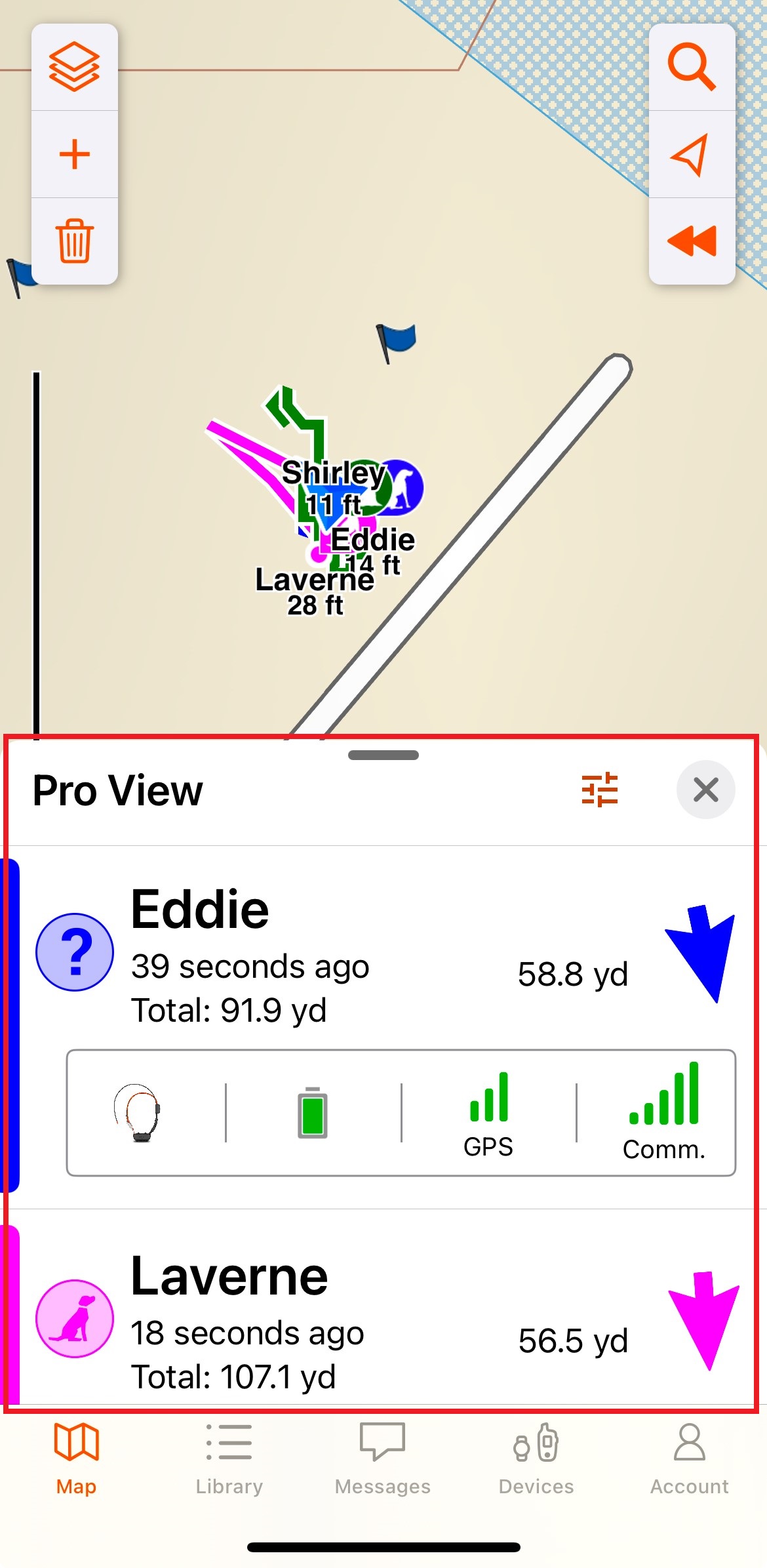

  4.   Selecting and pulling up from the top of the Pro View tab will expand the compass view.
    Compass full view

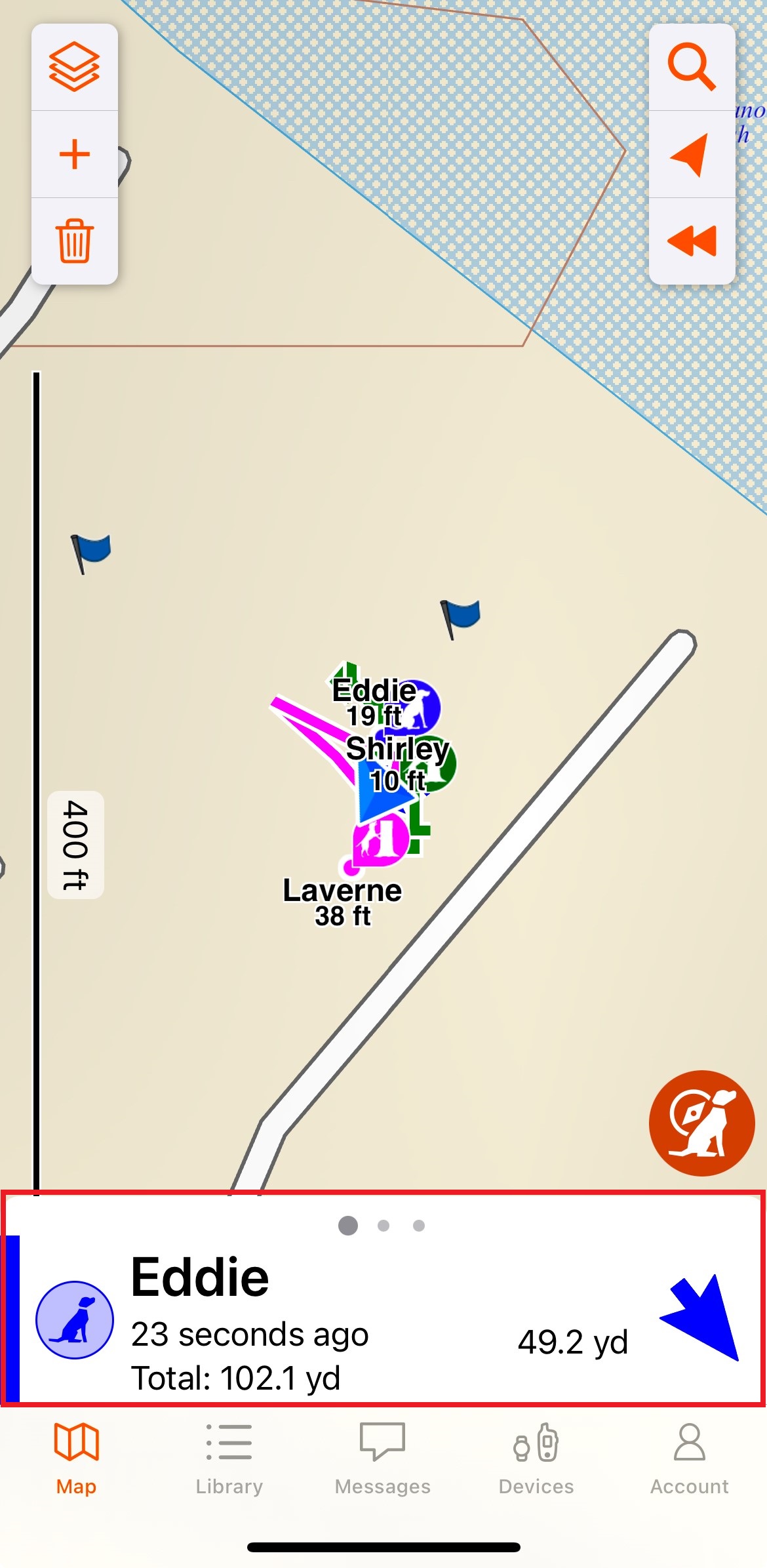

  5.  Select one of the dogs for a smaller single view. In this view select the dog and slide your finger left or right to view the previous or next dog.
    Compass Single View Alpha App

When using Pro View you can toggle on and off device information and bark detection (if available).
In Multi-dog view,
  1. Select the Settings Pro view settings icon.
  2. Select Devices to view Battery, GPS and Communication of the tracked devices.
  3. Select Bark to turn on Bark Detection in the app.
  4. Select the Settings icon again to hide the menu.
