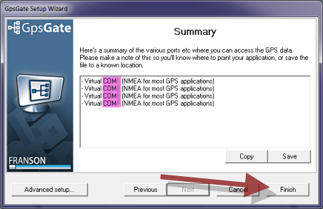

  8. Ensure the I want to share my GPS between several applications option is selected and click Next.
  9. The GpsGate software will assign multiple COM Ports for the BU-353. Write down or note the numbers of the COM Ports listed and click Finish.
