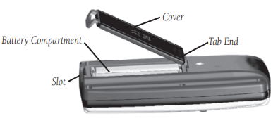

  1. Remove the battery cover by inserting a coin in the bottom slot. Twist the coin to lift the cover up and pull away.
  2. Compare the battery polarity with the diagram in the battery compartment and install the batteries accordingly.
  3. Re-install the battery cover by sliding the tab end in first and then snap the bottom section to the base of the unit.
    Geko Battery Compartment
