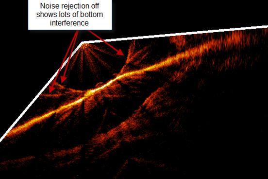

Noise Reject
Noise Reject settings have the following effects:
              • Off: Noise rejection is disabled, showing the most raw signal from the transducer
                • This can result in increased interference
              • Low: Removes trolling motor noise and interference from other sonar sources
              • Medium: Removes trolling motor noise, interference from other sonar sources, and bottom artifacts
                • This is the recommended Noise Reject setting
              • High: Smooths out the picture and more aggressively hides artifacts
      Examples of returns with Noise Reject disabled
      Noise rejection off of a ghost tree Semi-circular bottom returns with noise reject disabled

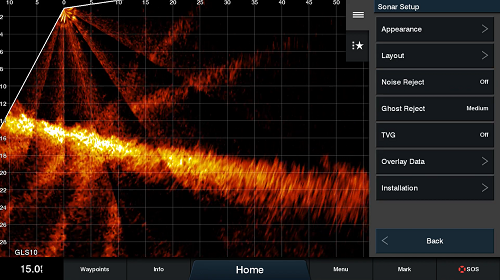

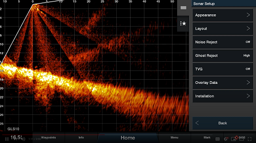

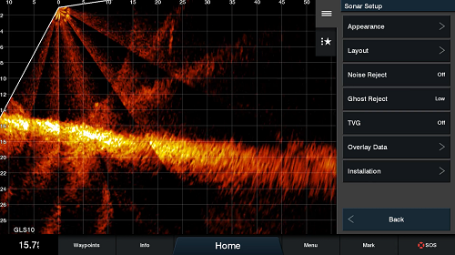

Ghost Reject
Ghost Reject shifts some power from the downward-looking elements of the transducer to the forward-looking elements. This lessens the effect of phantom rays and objects appearing on-screen due to signals bouncing off of bottom and being incorrectly reflected at the transducer. This is especially useful in shallow water with a hard bottom.
To adjust Ghost Reject
          1. From the LiveScope screen, select Menu
          2. Select Ghost Reject
          3. Set Ghost Reject to Low, Medium, High, or Off depending on current needs
Examples of returns with Ghost Reject set to Off, Low, Medium, and High
Ghost Reject Off
Ghost Reject Low
Ghost Reject Medium
Ghost Reject High
