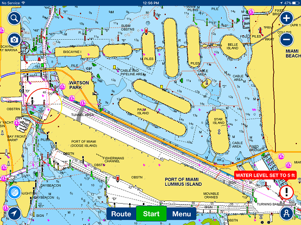

If the Water Level is changed to a positive number (indicating that the water is deeper than referenced on our original charting) it will cause a hazard warning to appear on your map screen. Tap the symbol to get more information.

Water Level Hazard Warning
Warning shown in lower-right of screen when water level changed
