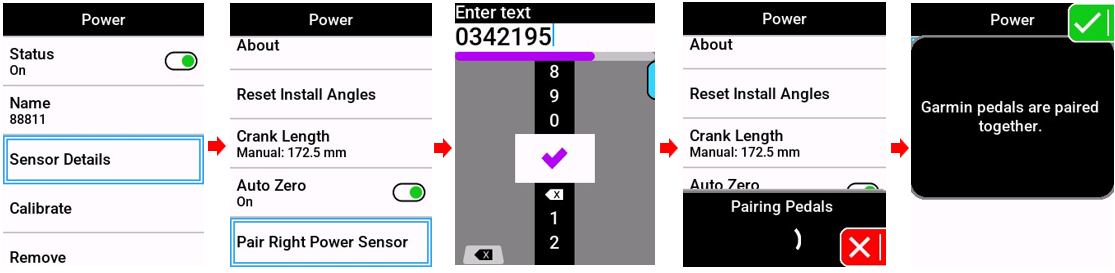

Pairing on Edge
NOTE: Steps may vary slightly between Edge models. The follow screenshots are shown on an Edge® 540 cycling computer.
  1. Select the Edge's list of Sensors.
  2. Select the Rally 100 power meter.
  3. Select Sensor Details.
  4. Select Pair Right Power Sensor
  5. Enter the right side pedal's 7 digit ANT ID (etched on the spindle).
  6. Select Enter.
  7. Allow the Edge to connect the right side, this may take several minutes.
pairing right side power meter in edge 540 screenshots

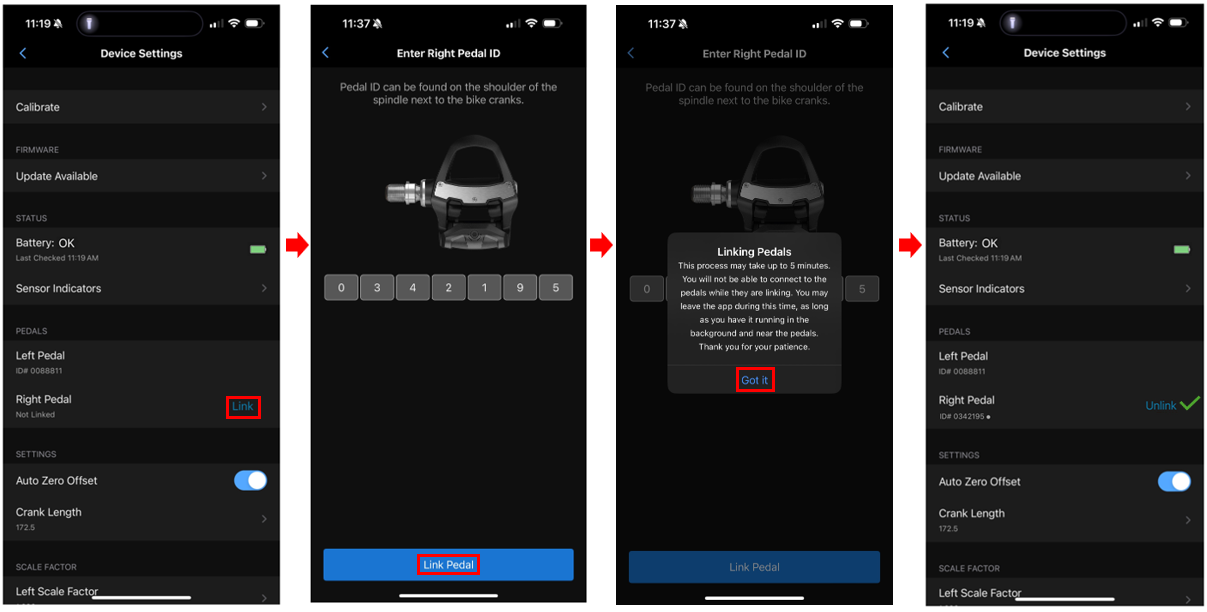

Pairing on the Garmin Connect App
NOTE: If you use a 3rd party cycling computer or compatible Garmin watch, you will need to use these steps to pair the right side pedal.
  1. Open the Garmin Connect app.
  2. Access the menu by selecting More (bottom right).
  3. Select the Rally power meter.
  4. Select General.
  5. Select Link (next to Right Pedal).
  6. Enter the right pedal's 7 digit ANT ID, which can be found etched on the spindle.
  7. Select Link Pedal
  8. The pairing can take several minutes.
  9. When the right pedal is successfully linked, you will see Unlink as the option.
screenshots of linking pedals in garmin connect app
