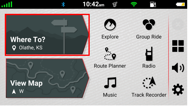

1. Touch Where To?

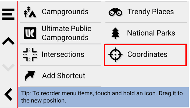

2. Touch Coordinates

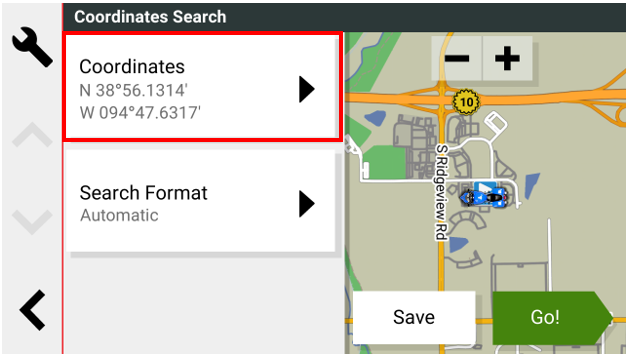

3. Touch Coordinates again

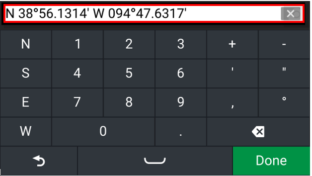

4. Enter the latitude and longitude

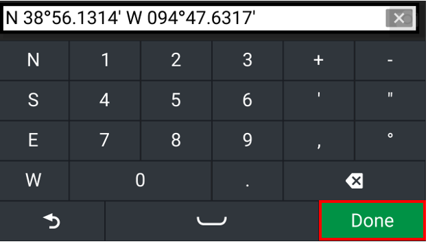

5. Touch Done

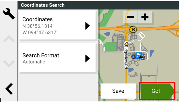

6. Touch Go
The device will now begin navigating you to the entered coordinates.
When given coordinates for a GPS position, you may find the format does not match the device's format or that the coordinates have too many numbers.
Touch Search Format if the desired coordinates do not match the format used on the device. You can also touch the  wrench icon to view all the available Position Format options. This will allow you to access additional information such as Display Format, Datum, Map Spheroid, and Reset. If the formatting of the coordinates does not match the format on the device, confirm the format of the provided coordinates. Maps will often provide the position format they use.
