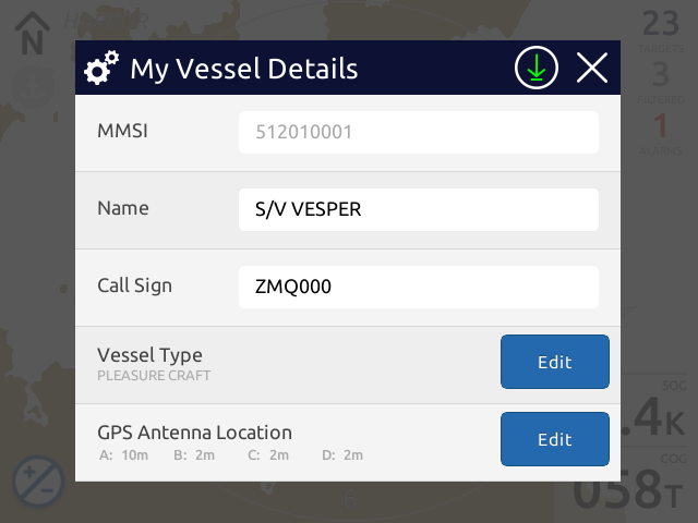

Configuring vessel details
WatchMate Vision2 will not transmit until vessel details have been configured. The dealer may have already configured this information and this procedure can be used to verify the information is correct.
The vessel must have an assigned MMSI number. If the vessel doesn't have an assigned MMSI, contact the relevant authority in the country of residence.
Once the MMSI number is configured, it cannot be changed. To change the MMSI, contact an authorized dealer or Vesper Marine.
Vessel details may be configured or viewed directly on the WatchMate Vision2 or using either the Vesper Marine WatchMate® App for iPhone and iPad or Android phones and tablets. Users can also use the vmAIS Configuration and Status Utility (see downloads section). To use the utility, download and install it on a PC or Mac computer. Connect to WatchMate Vision2 via USB or Wi-Fi.
On the Vision2, from the Settings Menu choose AIS Settings and edit My Vessel Details. Enter the  MMSI and other details carefully since this information is transmitted to all vessels within range. Select the most appropriate vessel type and enter the location of the GPS antenna. Enter the location in either meters or feet. Measurements in feet are converted to whole meters for transmission. As a result, not all measurements in feet can be represented.
My Vessel Details

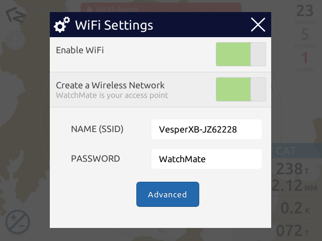

Setup Wi-Fi to create its own network as an access point
The WatchMate Vision2 transponder comes already configured as an Access Point. This is the most common way to use the WatchMate Vision2 and it allows the user to connect up to eight other devices via Wi-Fi. A separate Wi-Fi router is not needed.
The default network name (SSID) is VesperXB-[Serial Number]. Select this name from the Wi-Fi connection screen on your other devices. The default password is printed in the owner's manual.
Change the SSID or password by using the Wi-Fi Settings on the WatchMate Vision2 or by using the vmAIS Configuration and Status Utility on a PC or Mac computer. It is recommended to change the password. To do this, use the Wi-Fi Settings dialog which is accessed from the Settings Menu. Alternatively, a user can do this by downloading the vmAIS Configuration and Status Utility (see downloads section) and installing it on a PC or Mac computer. Use the USB cable that is included with the WatchMate Vision2 transponder to connect to the computer. Some versions of Microsoft Windows have the driver pre-installed, but if not or if installing on Mac OS, it can be downloaded.
Select the Wi-Fi Settings from the Settings Menu to change the SSID and enter the new password.
Watchmate Wi-Fi Vesper

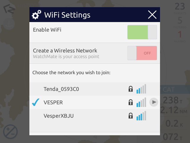

Setup Wi-Fi to join an existing network
If there is an existing Wi-Fi router, configure the WatchMate Vision2 to connect to it rather than create its own network. This allows users to maintain a single network connection on other devices without having to switch networks to get access to the WatchMate Vision2 transponder. This also allows for larger networks than the eight devices supported by the WatchMate Vision2 in its Access Point configuration.
To configure the WatchMate Vision2 to join an existing network, use the Wi-Fi Settings dialog accessed from the Settings Menu. Alternatively, users can use the vmAIS Configuration and Status Utility on a PC or Mac computer. To do this, download the vmAIS Configuration and Status Utility (see downloads section) and install it on a PC or Mac computer. Use the USB cable that is included with the WatchMate Vision2 transponder to connect to the computer. Some versions of Microsoft Windows have the driver pre-installed, but if not or if installing on Mac OS, it can be downloaded.
On the Vision2, from the settings menu, select Wi-Fi Settings. Turn off Create a Wireless Network. It will take a few seconds for the WatchMate Vision2 to reconfigure itself and display a list of networks within range.
Vesper Wi-Fi Client

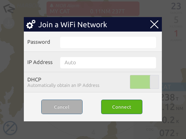

Joining Wi-Fi Network
Select the network to join by clicking on its name. Enter the network password, if required. The WatchMate Vision2 transponder supports WPA and WPA2 personal (PSK) Wi-Fi security.
The default is to use DHCP which allows the Wi-Fi router to choose the address for the WatchMate Vision2. This is convenient but the address can change if the WatchMate Vision2 transponder is powered off. To assign the  WatchMate Vision2 a static IP address, untick the "Use DHCP" option and enter the IP address to use. This must be an IP address in the correct range which the router has available for use as a static IP. See the manual for the Wi-Fi router for details regarding static IP usage and the correct address to enter.
The WatchMate Vision2 will now connect to the network. When it is done, the selected network will appear in the list with a blue tick next to it. If using DHCP, click on the grey arrow next to the network name to see the IP address that has been assigned by the router. Use this address to connect to the WatchMate Vision2 from other devices on the network.
