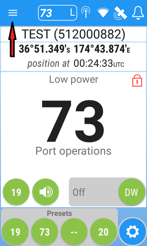

From any view-tap the menu button or icon on the handset.

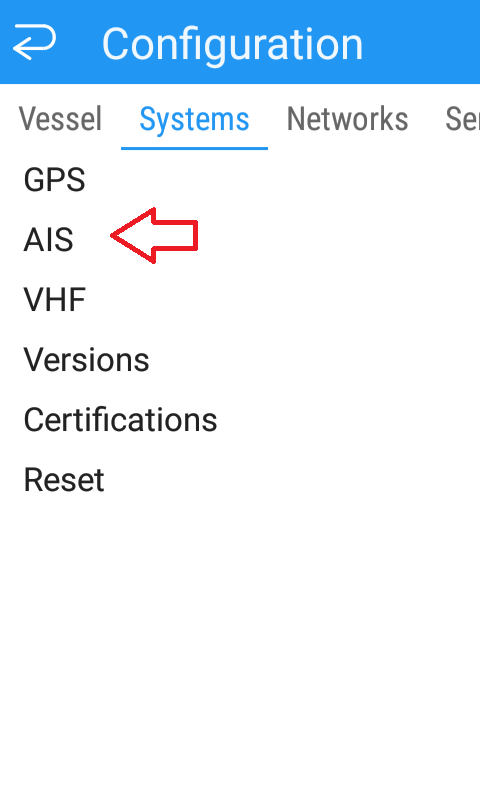

Next tap the configuration (wrench) > systems > AIS.
