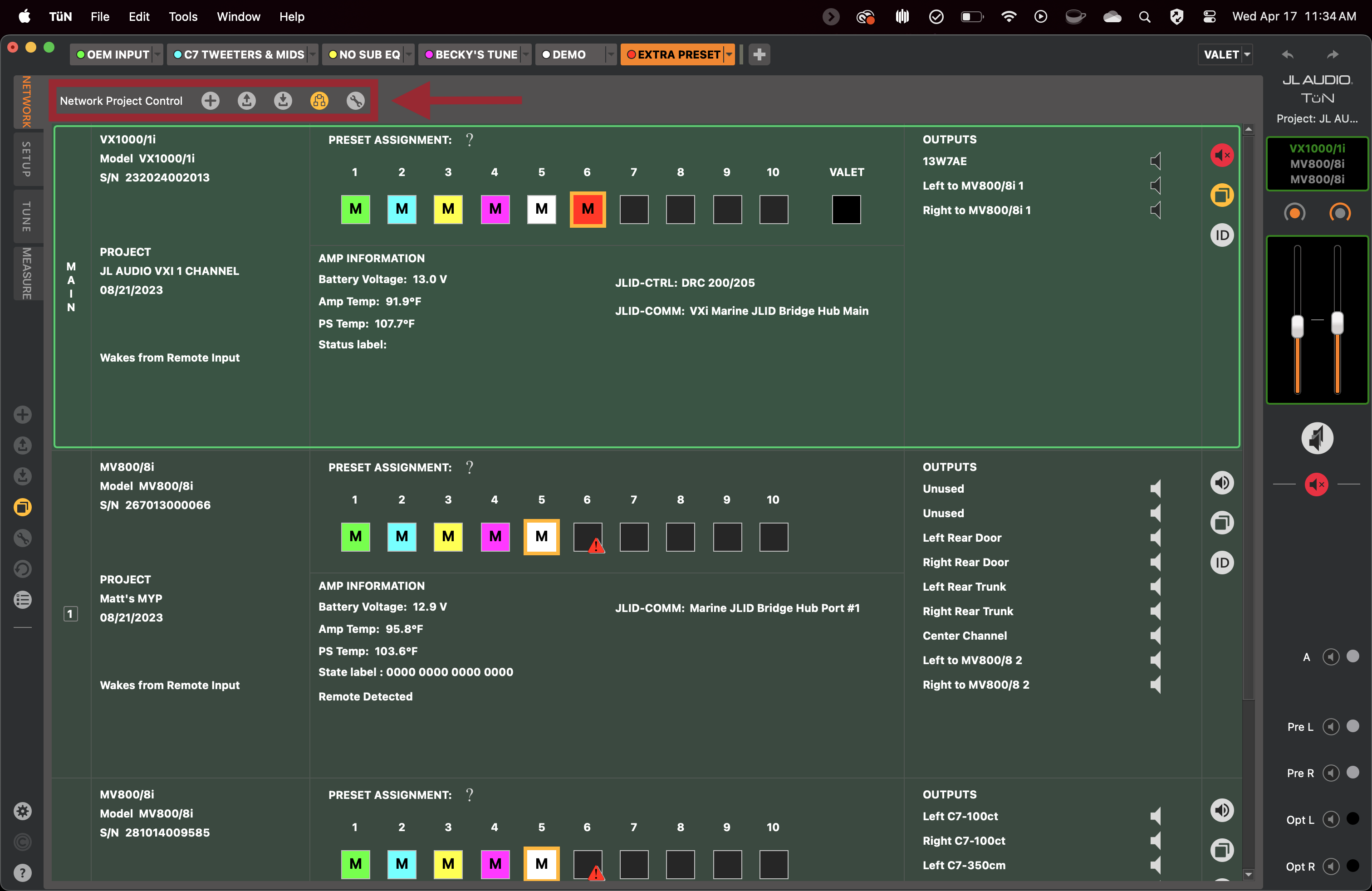

If a network is being used, there will be Network Project Controls with a Transfer Projects to All Amps MXi Transfer Project to All Amps Button button visible at the top of the Network Tab just below the presets. Selecting this button will transfer each individual project to each connected device without the need to switch to each device individually. If using a MVi-Hub, there will be additional buttons that allow Network Projects. This means that a single Network Project for all devices can be opened or saved from the Network Tab.
MXi Network Project Control
Figure A displays Network Project Control just under the Presets (MVi-Hub Only)

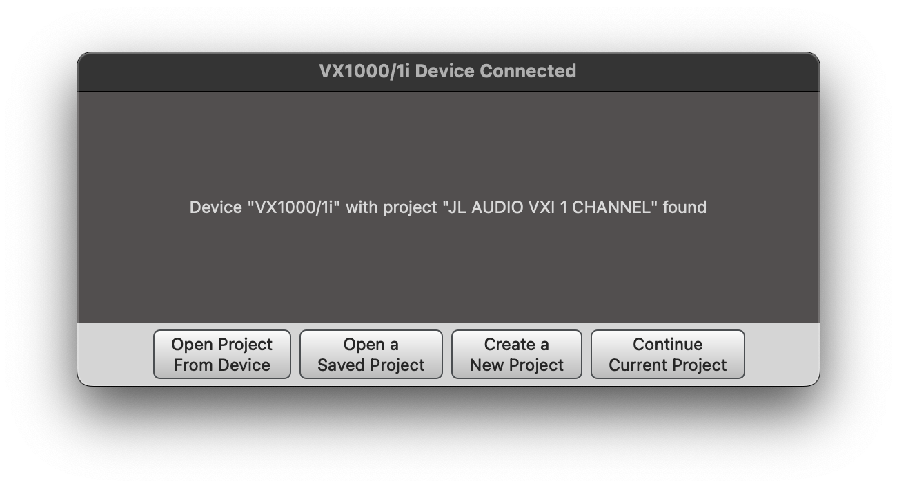

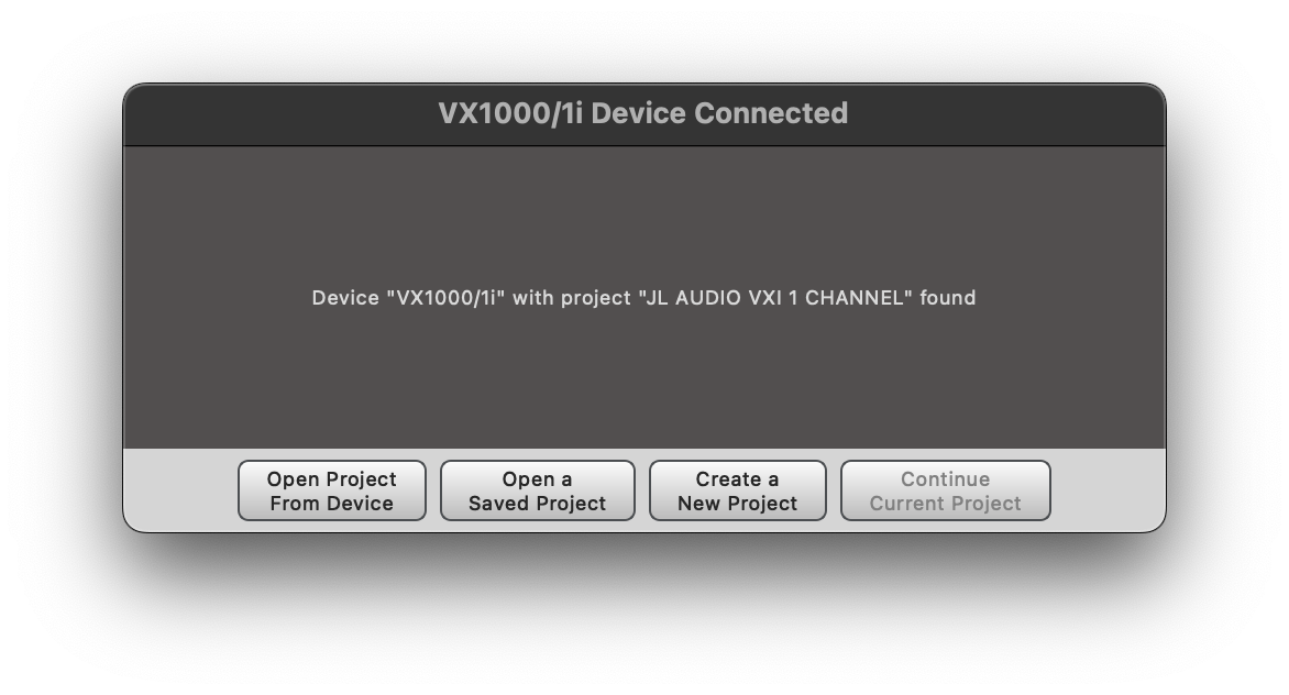

When connecting a device to TüN® Software, there are several possible dialog windows that a user may experience. If TüN® is launched with a device connected, after selecting that device, the user will likely see the dialog window in Figure B. The user can open the project that is currently on the device, open a previously saved project or create a new project. If TüN® was already open with a project open of the same device type, the user will see the dialog window in Figure C. This dialog will allow the user to continue the current project that is open in TüN®. Beware, choosing this option will result in the current project being stored in temporary memory on the device. If this option was selected by mistake, the user should disconnect the device and power it down. Any project that was previously stored on the device should remain intact as long as the user didn’t select the Transfer Project to Device button VXi Transfer Project to Device Button.
MXi Figure B
Figure B displays Device Connected with several options
MXi Figure C
Figure C displays Device Connected with several options

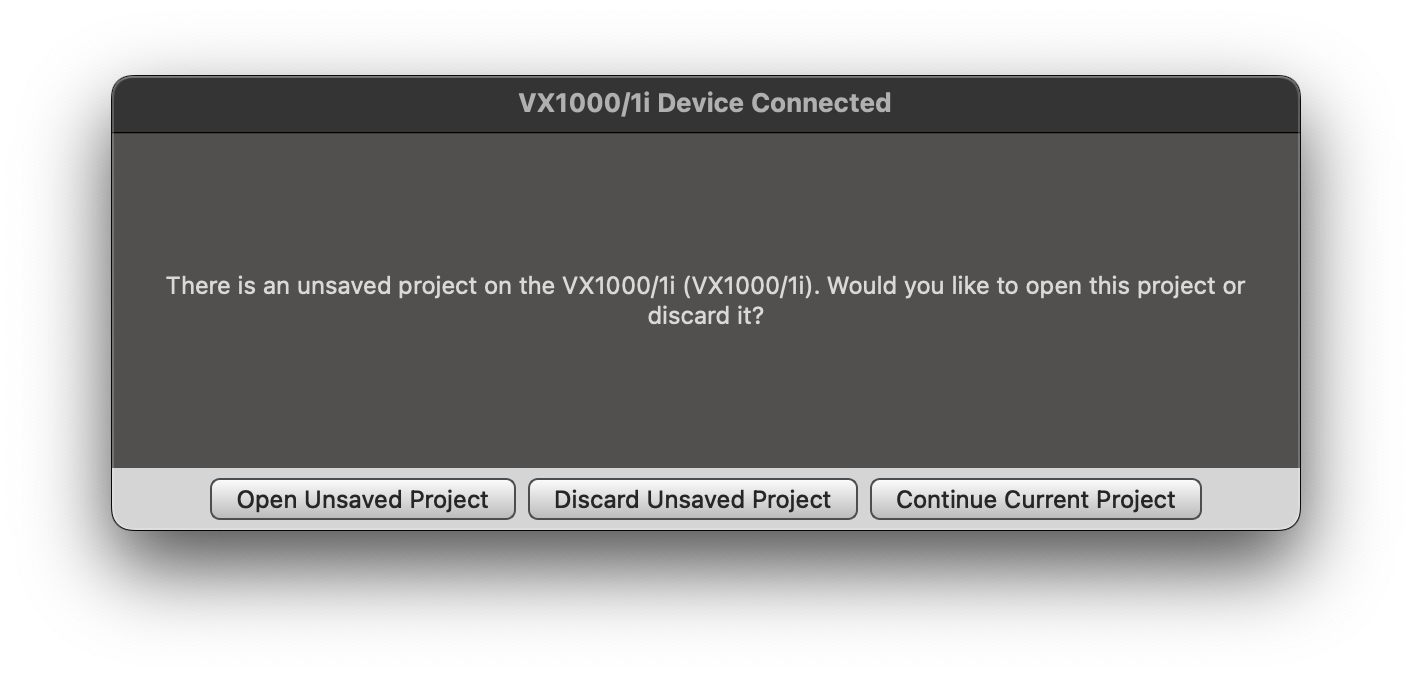

If there is a project on the device that has been retained in temporary memory, the user will see the dialog box in Figure D. The user can open the unsaved project from the device, discard the unsaved project and create or open a new project, or continue the current project that is still open within TüN® Software.
MXi Figure D
Figure D displays device connected with unsaved project in temporary memory
