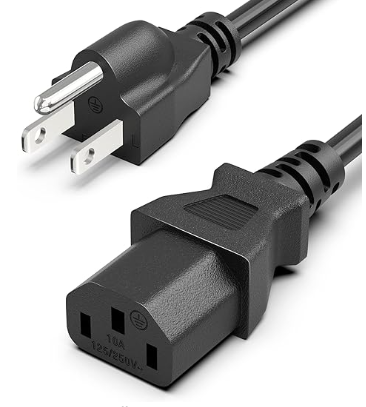

Flux Smart Trainers
  • Tacx® Flux
  • Tacx® Flux S
  • Tacx® Flux 2
c13 cable for flux trainers
For Flux Smart trainers, the C13 cable plugs directly into the trainer and the wall. Depending on which country the trainer was purchased in, the included C13 cable will have a different plug style. This C13 power cable pictured above is included with trainers purchased in North America.

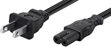

NEO and Flow Smart Trainers
  • Tacx® NEO
  • Tacx® NEO 2
  • Tacx® NEO 2T
  • Tacx® NEO Bike
  • Tacx® NEO Bike Plus
  • Tacx® Flow
C7 Power Cable with figure 8 end and two-prong end
For NEO series trainers listed above, the C7 cable plugs into the power adapter brick included with your Tacx trainer and then into a power outlet. For the Tacx Flow, the C7 cable plugs directly into the trainer and the wall. Depending on which country the trainer was purchased in, the included C7 cable will have a different plug style. This C7 power cable pictured above is included with Tacx trainers purchased in North America.

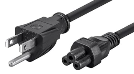

NEO 3M Smart
For the Tacx® NEO 3M Smart Trainer, the C5 cable plugs directly into the trainer and the wall. Depending on which country the trainer was purchased in, the included C5 cable will have a different plug style.
tacx neo 3m c5 power cable
The C5 power cable pictured above is included with Tacx NEO 3M Smart Trainers purchased in North America.
