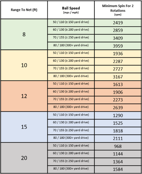

The distance from tee to net, ball speed, and how fast the ball is spinning affect the Approach R10 monitor’s ability to measure the spin rate. While at least 2 full rotations of the ball are needed before it hits the net to get the most reliable results, it is possible for the Approach R10 monitor to measure spin with fewer than 2 rotations. However, if there was not enough spin for signal capture, the Approach R10 monitor will estimate spin. At minimum you will need 8 feet from tee to net, but may need additional range up to 20 feet. The examples below can help determine if your Approach R10 monitor is showing an estimate, and the distance needed to capture at least 2 rotations.
Determining Distance From Tee to Net
Use the chart below to help determine distance from the tee to achieve enough ball speed for a minimum of 2 rotations.
Chart with numbers in columns

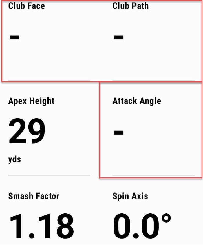

I Do Not See Attack Angle or Spin Axis
If are not seeing club angles in the Garmin Golf App for high spin, low smash factor shots it is possible that the signal from the RCT ball is interfering with the signal from the club.  You may need to use a standard golf ball if club metrics are what you are most interested in that case.
