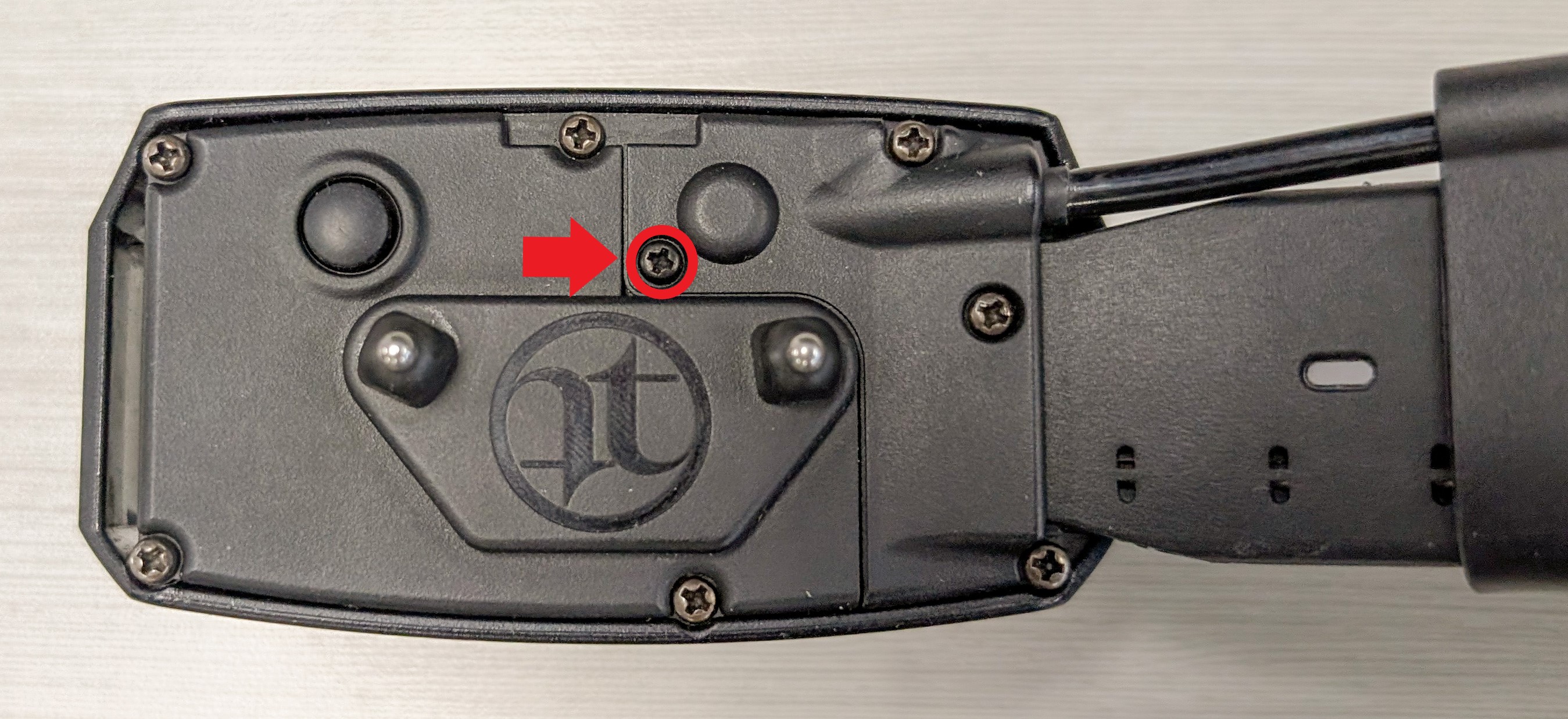

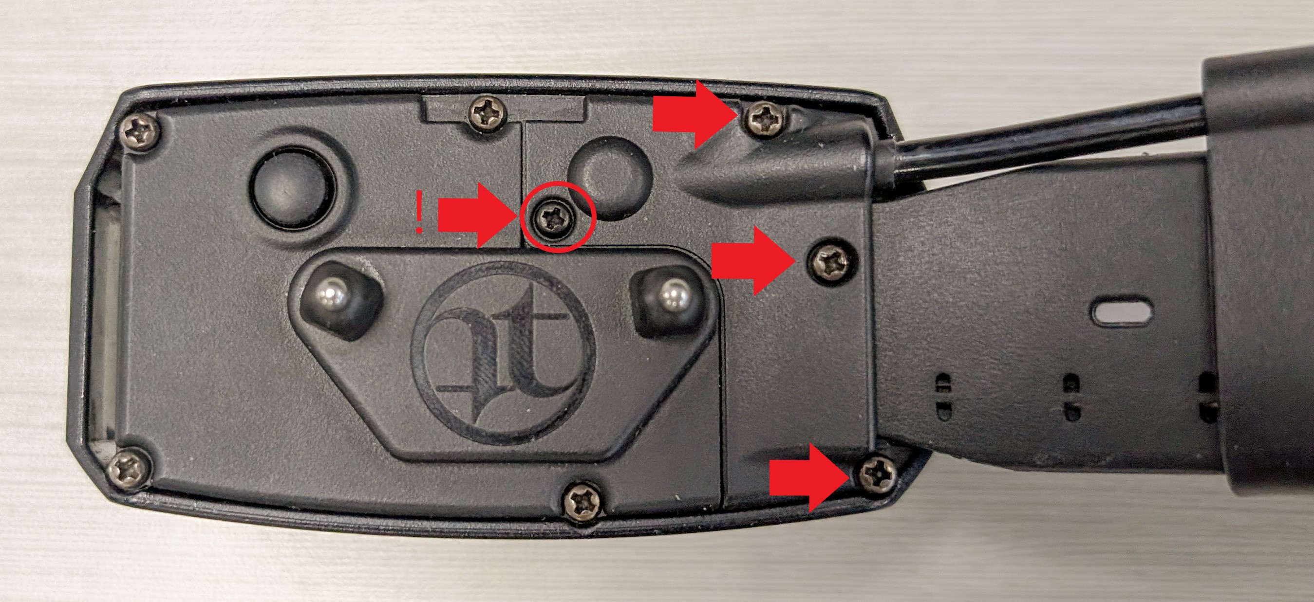

  1. Using the T-6 screwdriver, remove the 4 screws from the L-shaped clamp plate protecting the VHF antenna.
    NOTE!: The highlighted section in the image below is the location for the short screw.

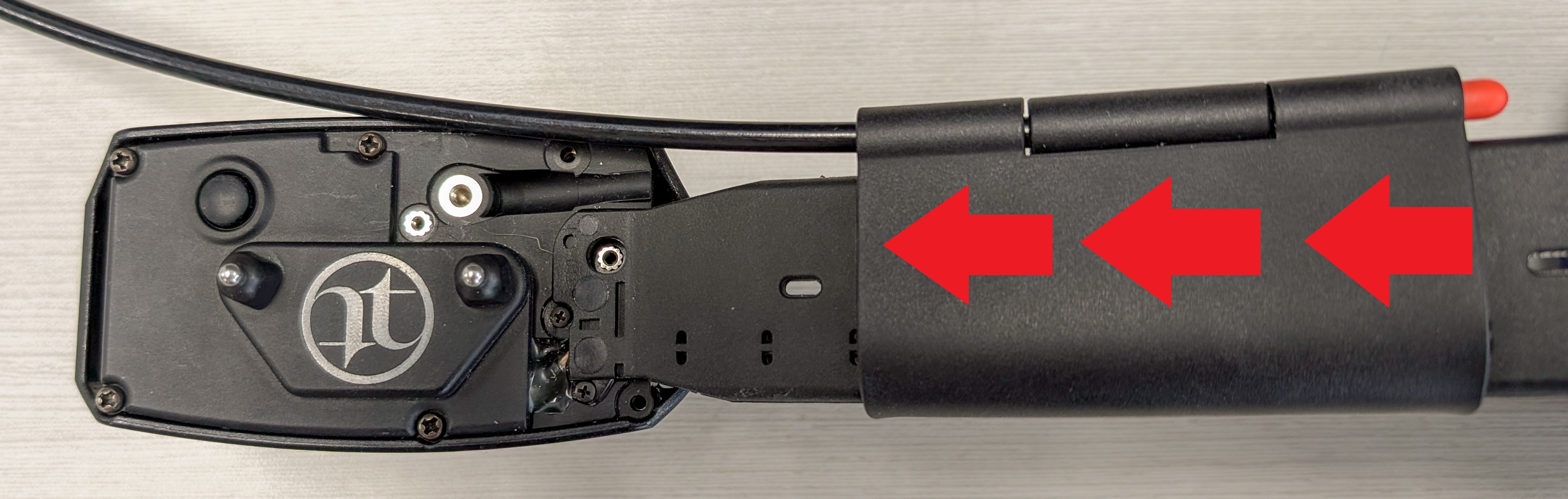

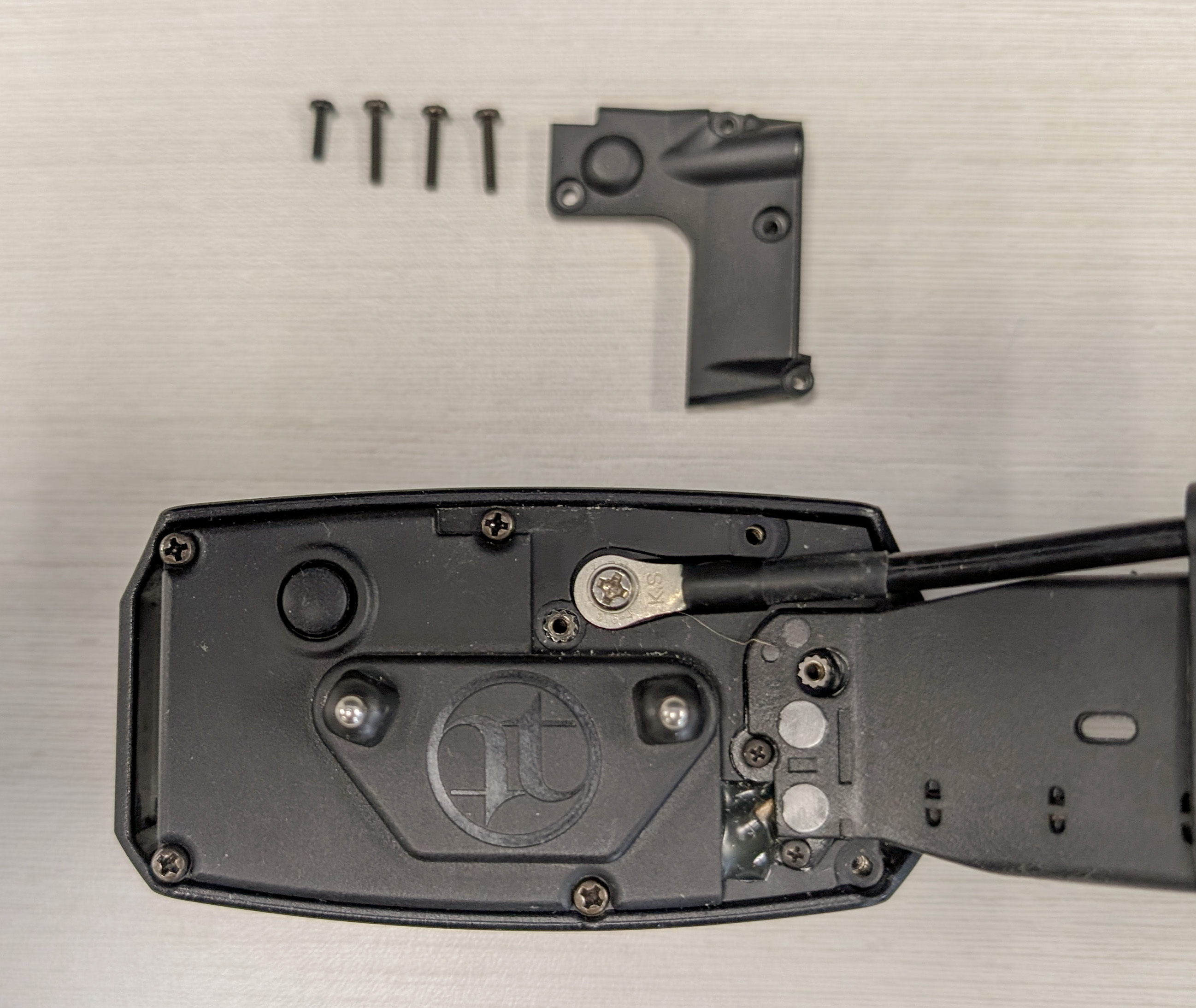

  2. Remove the clamp plate from the device and set screws and plate aside.  Note that one screw is shorter than the others.
    dog collar image4

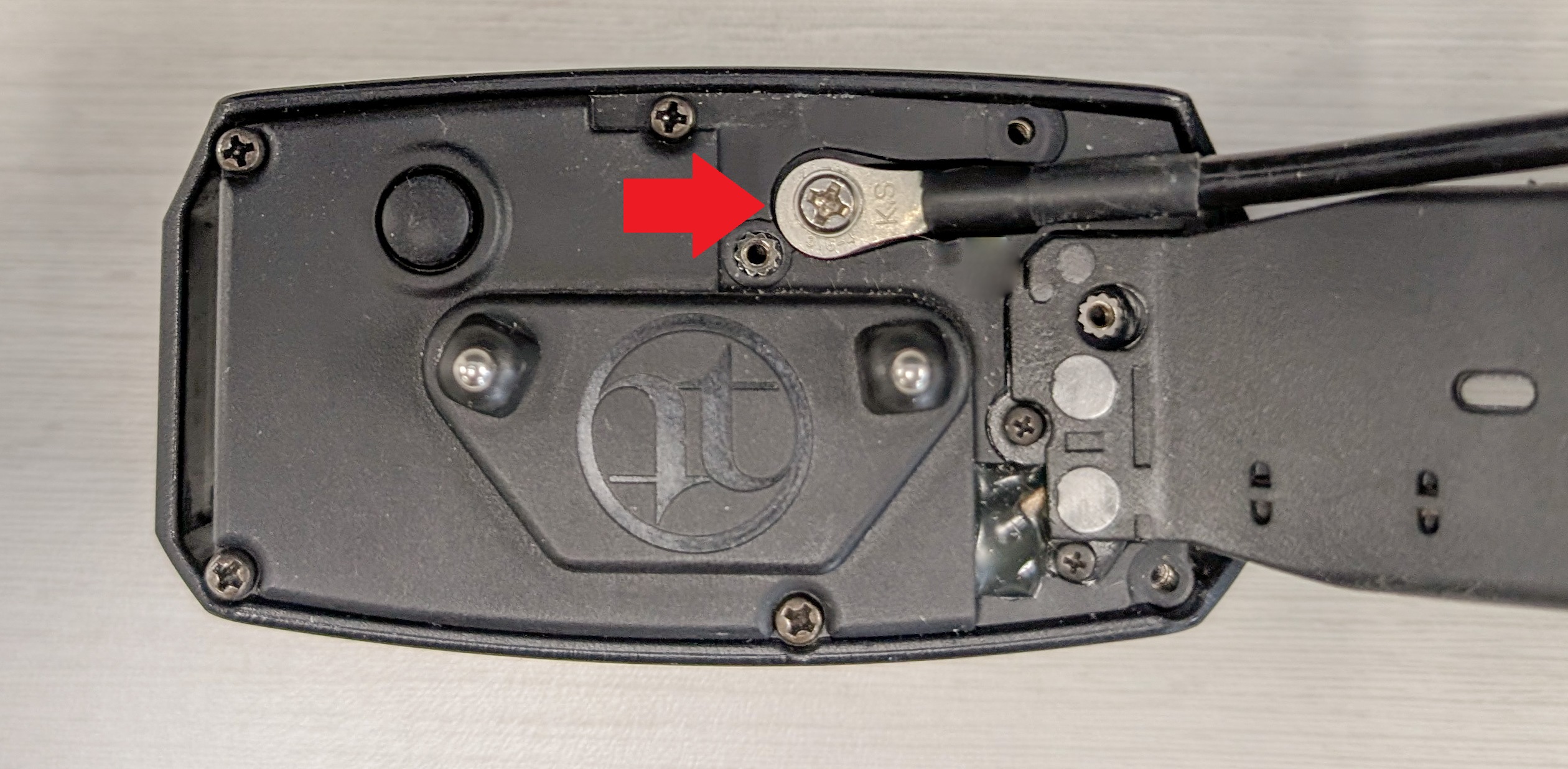

  1. Use the PH1 Phillips-head screwdriver to remove the screw securing the VHF Antenna and set aside.
