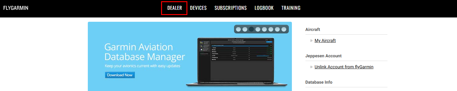

  1. Visit the flyGarmin.com® website and sign in using valid DRC credentials. Once signed in, a Dealer option will be available in the top of the page. Click this link to access Feature Enablements. Note that valid DRC credentials are all that are required to access this page, so a different technician or service center can access the feature enablement downloads for a particular System ID as needed.
    • flyg - dealer tab

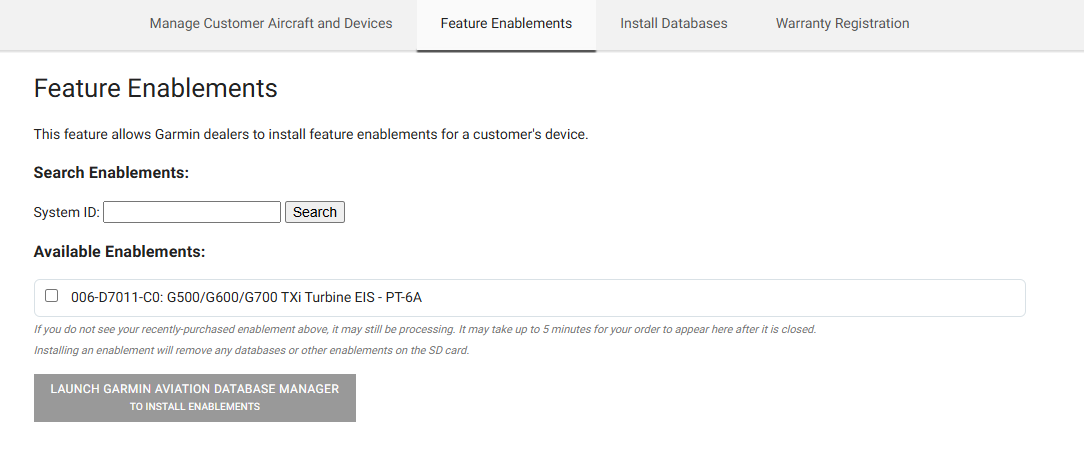

  2. Enter the appropriate System ID, and click “Search” to display the feature enablements available to download for the System ID entered. Select the feature enablements you wish to download, and click “Launch App” to open the Garmin Aviation Database Manager.  The app will then load each enablement onto a USB Flash Drive. Note that each feature enablement can be downloaded again as needed, so it is not necessary to store the feature enablement cards in the aircraft.
    • Feature Enablements
  3. Follow the instructions provided by the Garmin Aviation Database Manager. When prompted to insert a USB Flash Drive, Garmin recommends using a compatible blank USB Flash Drive (compatible USB Flash Drives are listed in the system’s installation manual). Note that only one feature enablement can be loaded on a USB Flash Drive at any given time. The Garmin Aviation Database Manager will overwrite any existing feature enablement loaded on a USB Flash Drive prior to loading the feature enablement you have selected.
