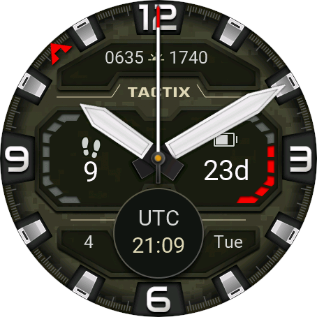

tactix8AMOLED2
Delta
This watch face will show a UTC time zone hand that corresponds with the 24 hour indicator on the watch bezel.
tactix8AMOLED1
Alpha

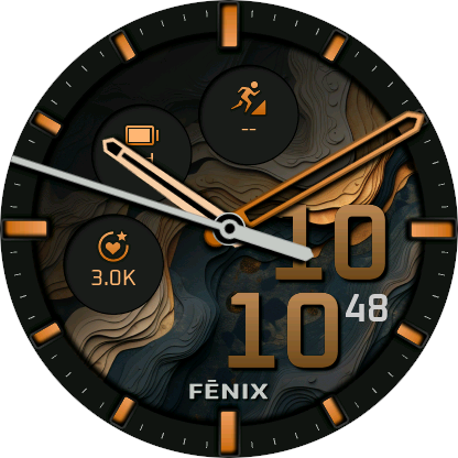

Digital Watch Face with a Gauge Data Field at the Top and 7 Text Data FieldsIron Grit
Analog Watch Face with Digital Time and 3 Circular Data Fields on a Background with Rock Striations like a Canyon Wall
Rock
Adjusting the Styles of this watch face changes the color of the time numbers and background colors.

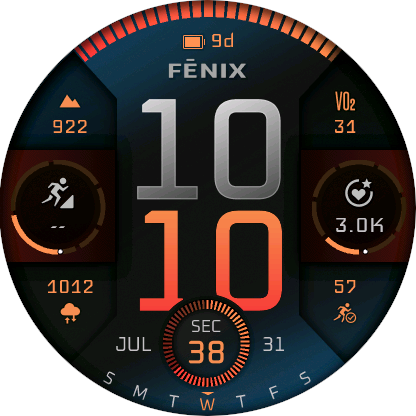

Digital watch face with data fieldsData Dash
Analog Watch Face With 4 Circle Data Fields With Gauges on the Left, 2 Gauge Data Fields in the Middle, 7 Text Data FieldsFrost

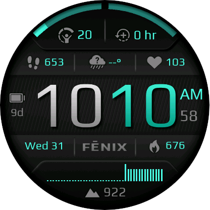

Digital Watch Face with 4 Gauge Style Data Fields
Razor
Adjusting the Styles on this watch face changes the background shading pattern.

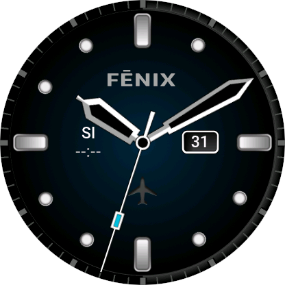

Analog Watch Face With 4 Text Data Fields
Deep Sea
This watch face can show an alternate time zone hand and track your no fly time after scuba diving.

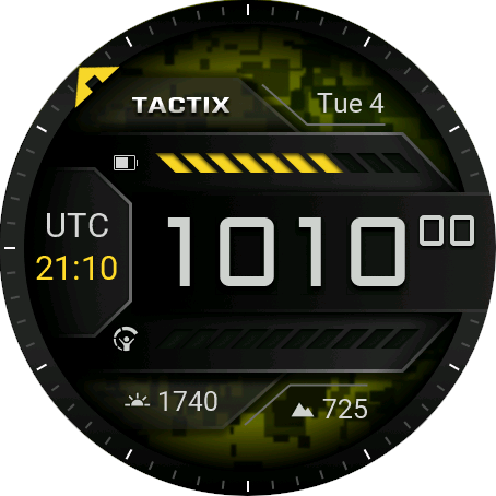

Digital watch face with 3 data fields
Industrial
