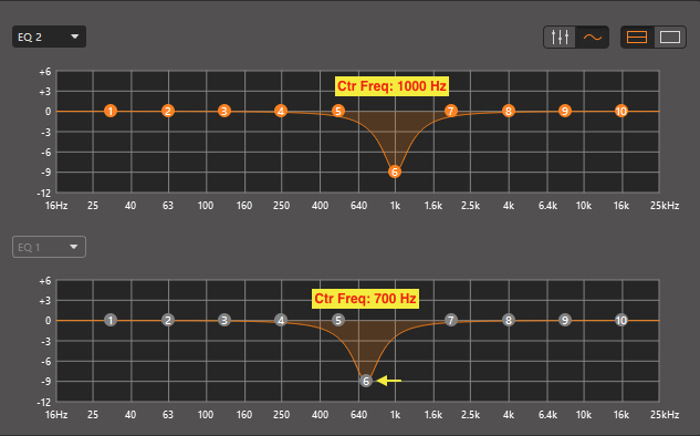

Figure 1 displays the effect of adjusting only the "Center Frequency" of a filter. Both graphs show a single filter with a "Q" of 1.41, and a Gain reduction of -9dB. The only difference is the "Center Frequency" value. The top graph indicates a Center Frequency of 1000 Hz for EQ Band #6. The bottom graph shows the effect of changing the Center Frequency downward, to 700 Hz. The TwK® allows you to select, for each EQ band, any "Center Frequency" value between 20 and 20,000 Hz. TwK Parametric 2
Figure 1

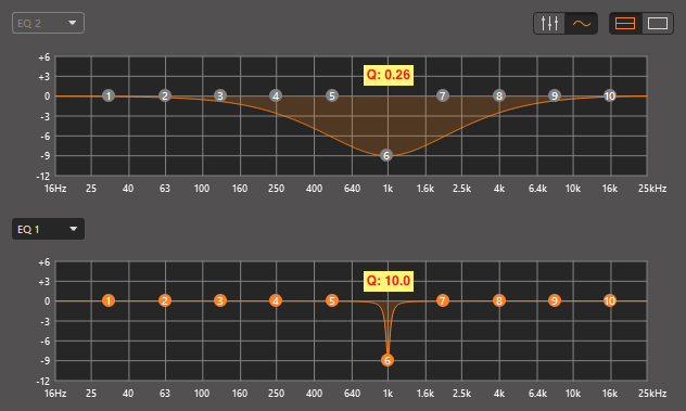

Figure 2 displays the effect of adjusting only the "Q" of a filter. Both graphs show a single filter with a Center Frequency of 1000 Hz and a Gain reduction of -9dB. The only difference is the "Q" value. The top graph shows the widest possible "Q": 0.26. The bottom graph shows a more narrow "Q": 10.0. The TwK® allows you to select from a wide range of "Q" values, giving you immense control over EQ correction.
TwK Parametric 3
 Figure 2

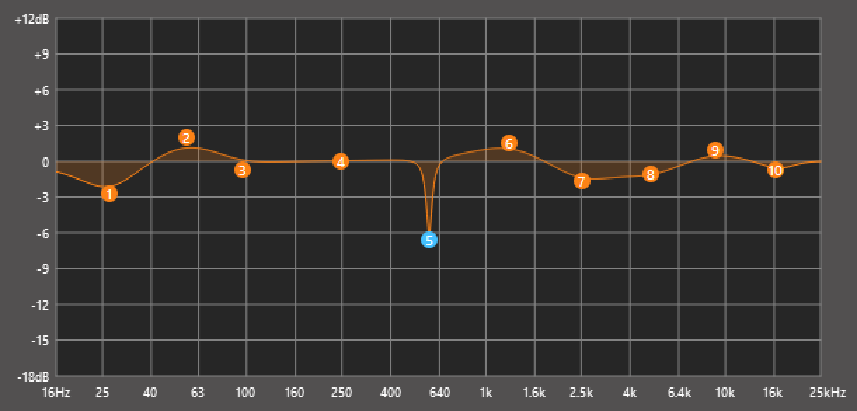

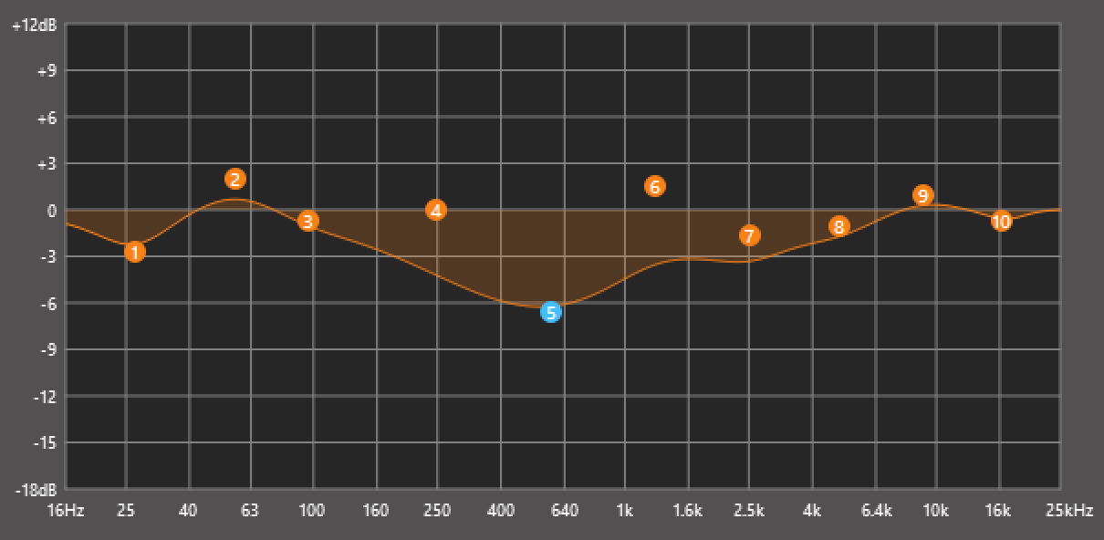

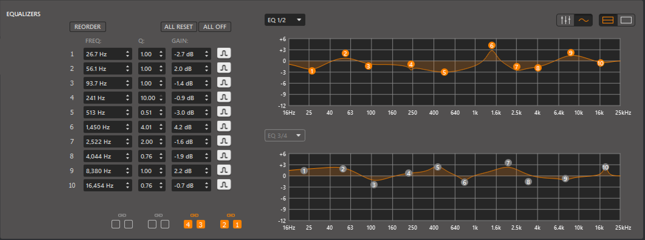

With a parametric EQ, it is possible to achieve highly complex frequency response curves using fewer filters than required with a graphic EQ. In practice, 10-bands of parametric equalization are just as powerful, if not more powerful, than 30 bands of graphic equalization. Here are two examples of complex curves, using multiple bands of parametric EQ.
TwK Parametric 4
Figure 3
TwK Parametric 5Figure 4
