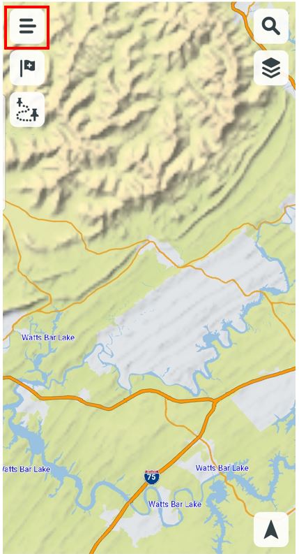

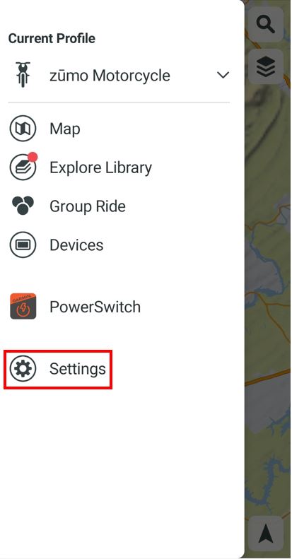

1. Open the Tread app
2. Touch the Menu Bars

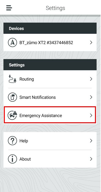

3. Touch Settings

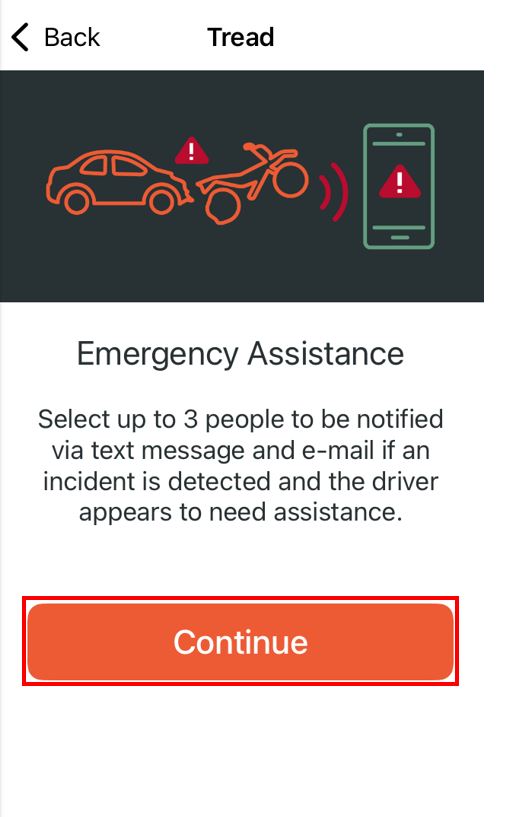

4. Touch Emergency Assistance
5. Touch Continue

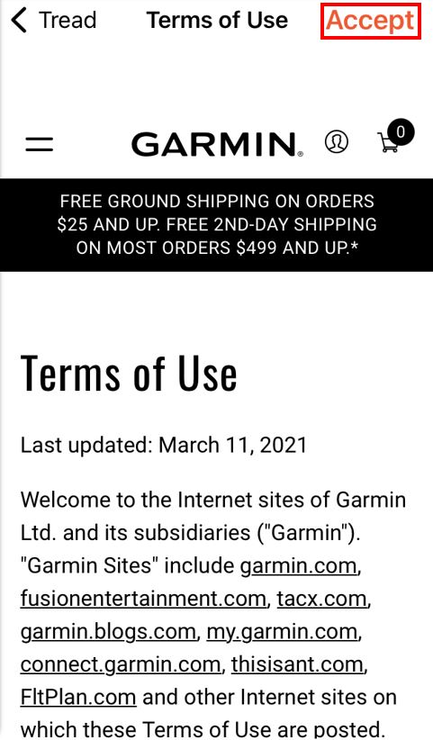

6. Read and Accept the terms of use

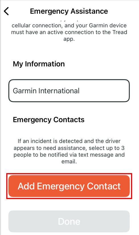

7. Touch Add Emergency Contact

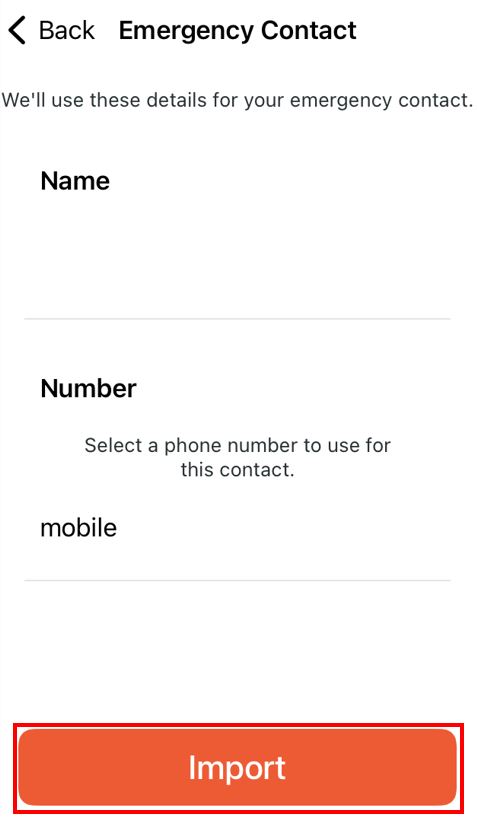

8. Select the contact from the list of contacts
9. Touch Import
10. Touch OK

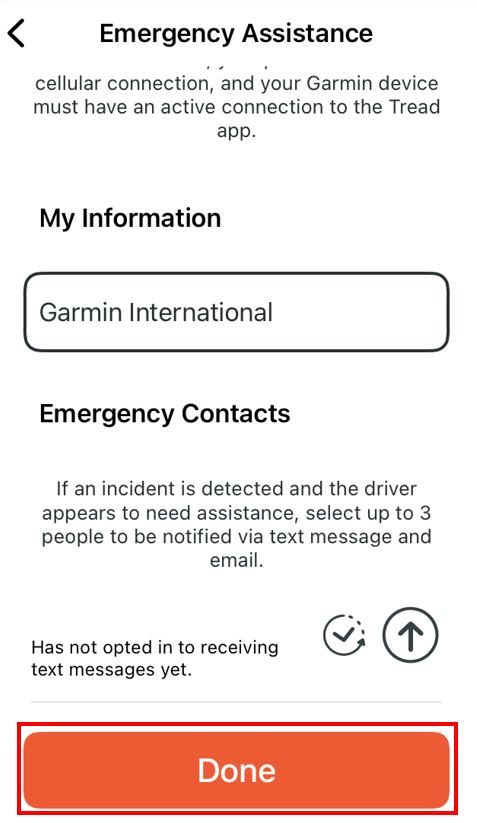

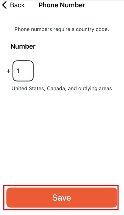

11. Touch Save

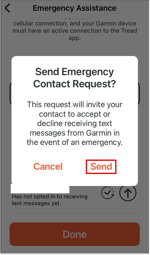

12. Touch Send to text a request to your emergency contact to receive text messages from Garmin in the event of an emergency
  • If you do not want to send the request, touch Cancel.
13. Touch Done
14. Access Emergency Assistance anytime with the above steps to do the following:
  • Add up to 3 emergency contacts
  • Remove contacts
  • Review contacts and their status (Ex. contact accepted, not yet accepted, or opted-out)

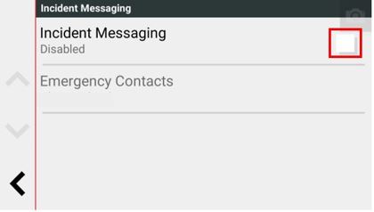

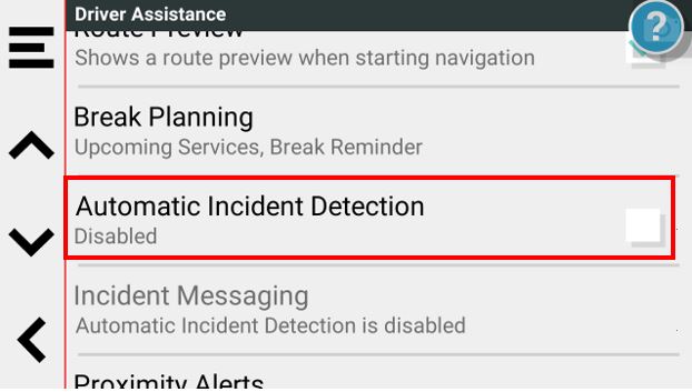

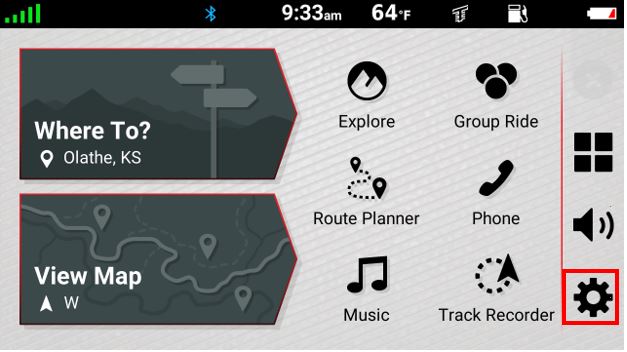

Enabling Automatic Incident Detection & Incident Messaging

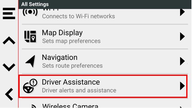

1. Touch Settings
2. Touch the down arrow on the left, then touch Driver Assistance

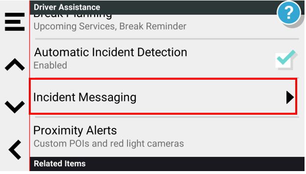

3. Touch the down arrow, then touch Automatic Incident Notification
4. Touch Incident Messaging
  • Place a check mark to enable Incident Messaging.
