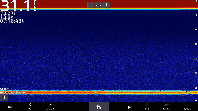

How to utilize RapidReturn
For a supported transducer* that is connected to a GSD 28, RapidReturn is enabled via the preset options in the Frequency menu.
RapidReturnGSD28
