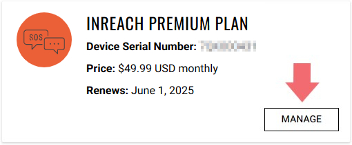

  2. Select MANAGE on the subscription you want to cancel.
    Manage Button

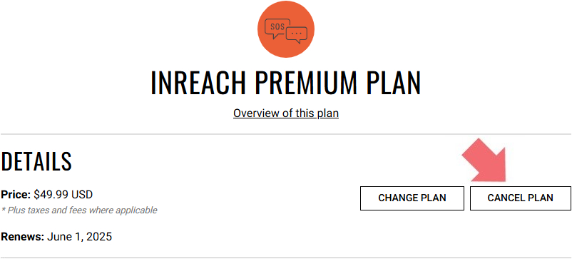

  3. Select CANCEL PLAN.
    Cancel Plan Button

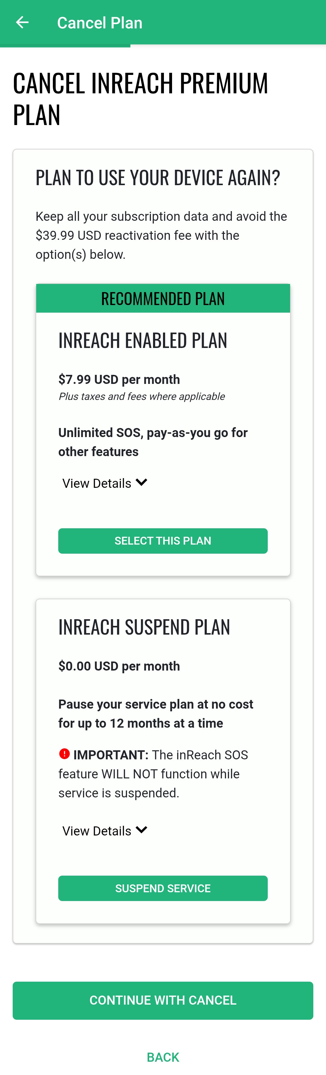

  4. If you are currently on an Essential, Standard, or Premium plan you will be prompted with an option to switch to an Enabled plan or suspend service.
    Select CONTINUE WITH CANCEL.

  6. If you are currently on an Essential, Standard, or Premium plan you will be prompted with an option to switch to an Enabled plan or suspend service.
    Earthmate Cancel Plan
  7. Select CANCEL IMMEDIATELY when prompted to finalize canceling service.
