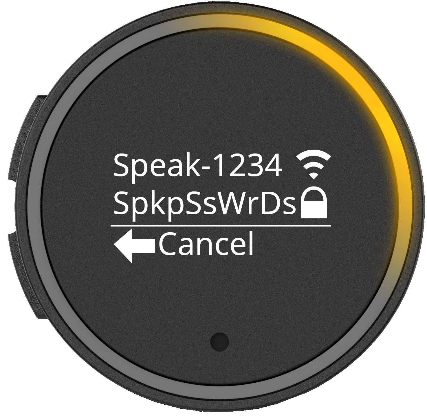

The Garmin Speak Plus cannot record video while the device has been placed into sharing mode with the Garmin Drive app. This is indicated by a rotating orange LED ring when the device is trying to establish a Wi-Fi connection with the Garmin Drive app, or a solid orange ring when the connection has been established.
Press the action (lower-left) button on the Garmin Speak Plus device to exit the sharing mode. It is not sufficient to exit the gallery or close the Garmin Drive app, which will instruct you to press the action button on the device.
