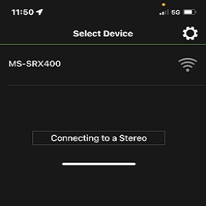

  3. Select the paired stereo
    connected stereo screen

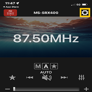

  4. Select the settings wheel
    stereo connected

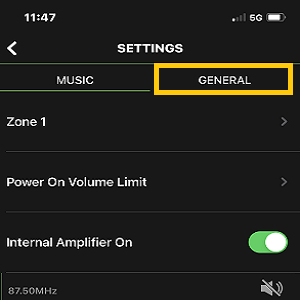

  5. Select General
    stereo settings

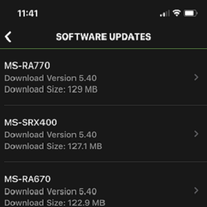

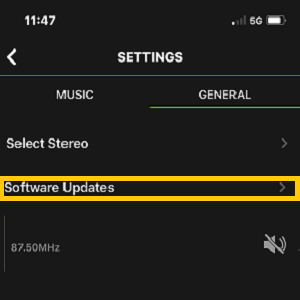

  6. Select Software Updates
    general settings

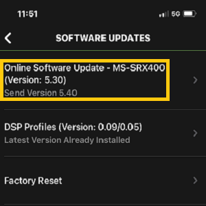

  7. Select the stereo to update
    software updates screen
    • If the stereo is up to date or a downloaded update is ready to be applied, it will be displayed here

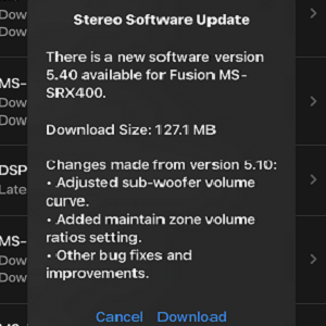

  8. Confirm the download
    download software

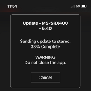

  11. The software will begin transferring to the stereo
    transferring update

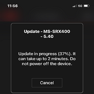

  12. When the update finishes transferring, the stereo will begin installing the update
    installing update
When the stereo finishes applying the update, it will restart and turn on normally.
