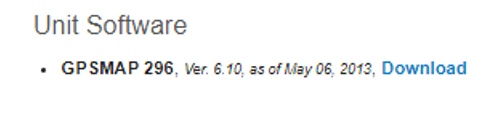

For the GPSMAP 296, follow this link and click on the Unit Software Download.

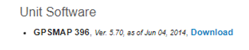

For the GPSMAP 396, follow this link and click on the Unit Software Download.

Once you have Clicked the Download Button,
  1. Agree to the terms and proceed to the download page.
  2. Click on the blue Download button:
