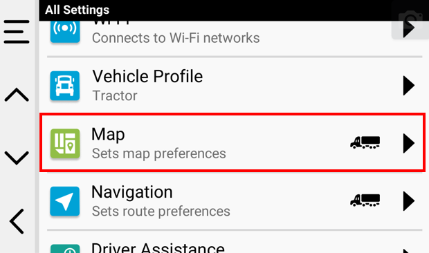

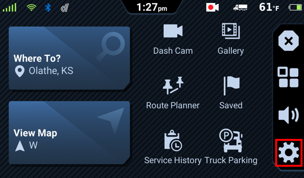

1. Touch Settings

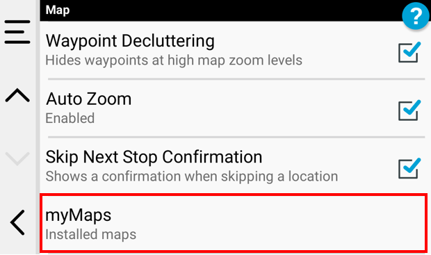

2. Touch Map
3. Touch myMaps

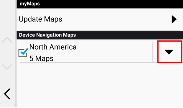

4. Touch the down arrow to display all maps

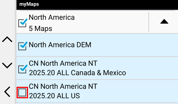

5. Enable the maps
The map is enabled if a checkmark is present.
Touch the empty box if a checkmark is missing.
