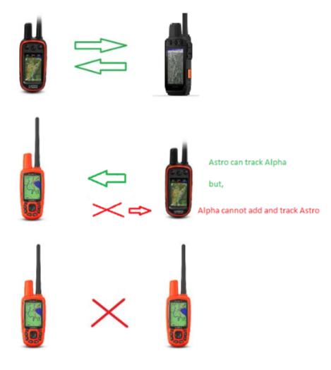

Communication between Alpha models and Astro 430s
  • The Alpha models can be added and paired to another Alpha model. In this set up, it can transmit and receive message and tracking data.
    • See manual for pairing options
  • The Astro 430 can add the Alphas however, the Astro 430 cannot pair back to Alpha.
    • Menu > Tools > Contacts > Follow Prompts
  • The Astro 430 cannot add and pair to other Astro 430 handheld.
The following diagram describes the different scenarios of how the Alpha and Astro 430 can add and pair with each other.
alpha 200i contacts
NOTE: The Astro 220 and Astro 320 cannot track or be tracked by an Alpha handheld.
