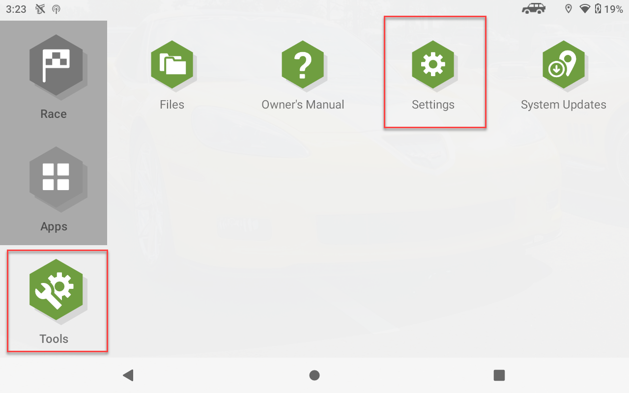

  1. Touch Apps

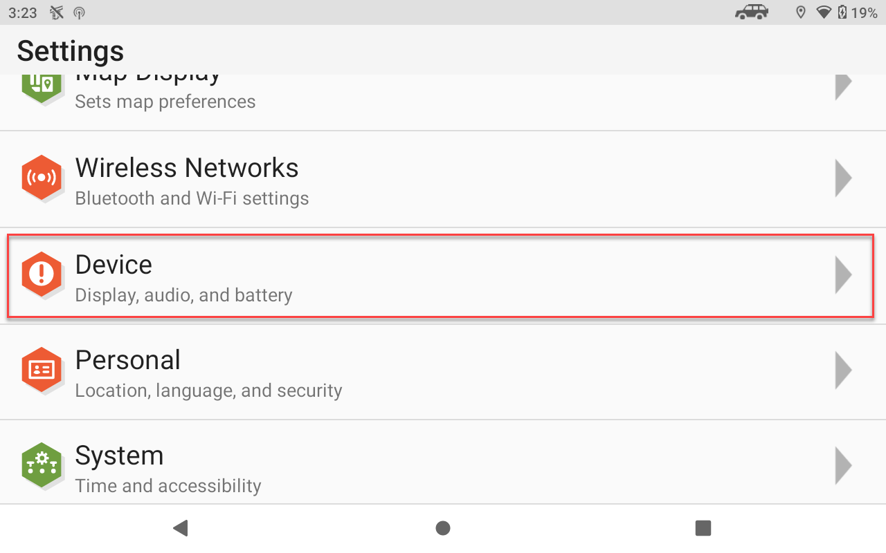

  2. Touch Tools, then Settings

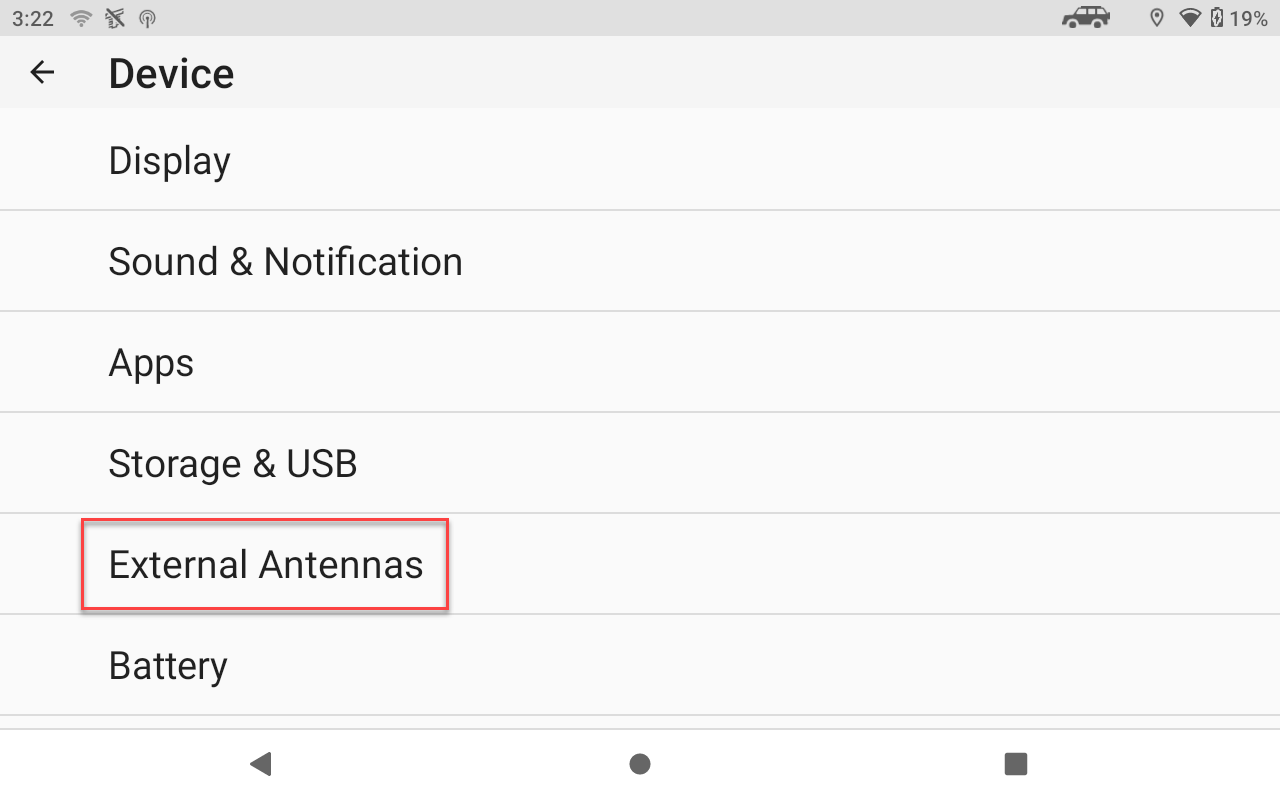

  3. Scroll down, and touch Device

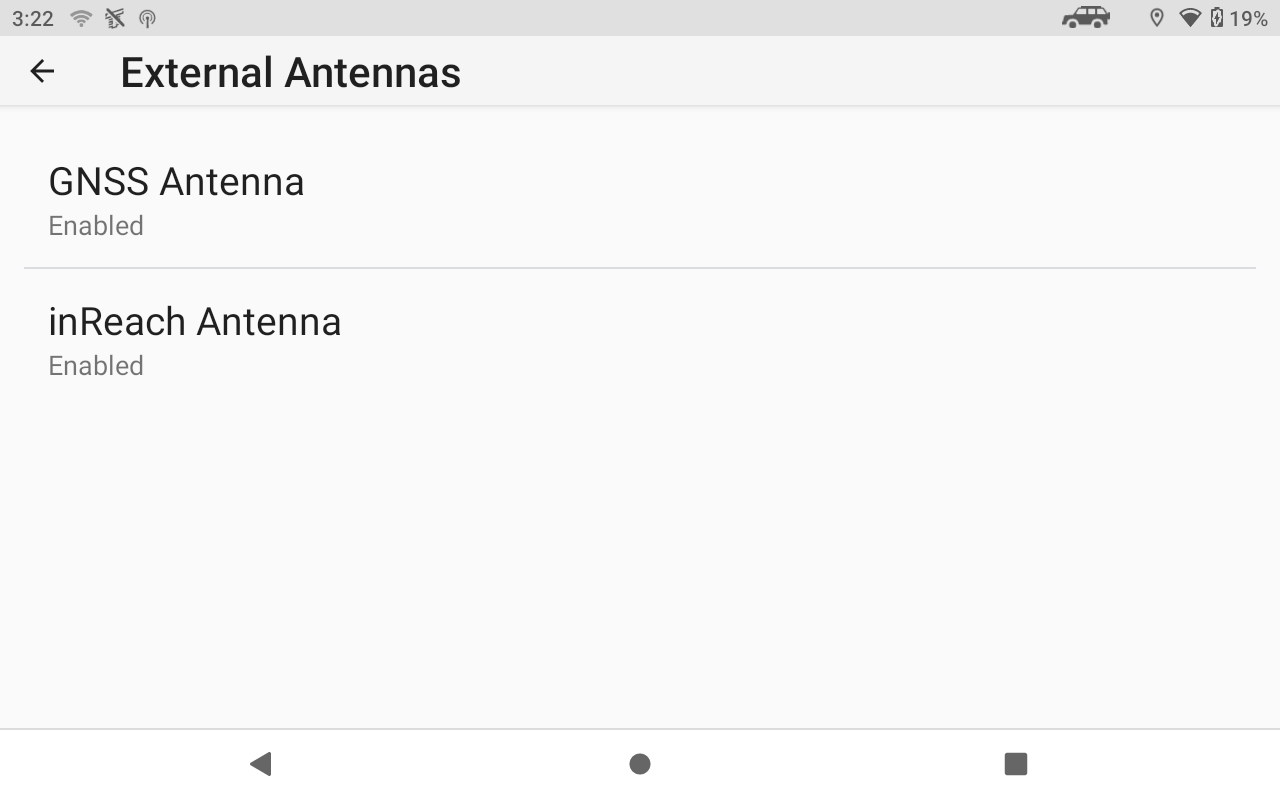

  4. Touch External Antennas

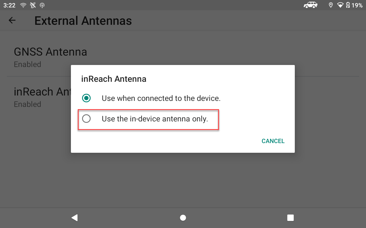

  5. Touch the antenna to disable
  6.  Select Use the in-device antenna only.

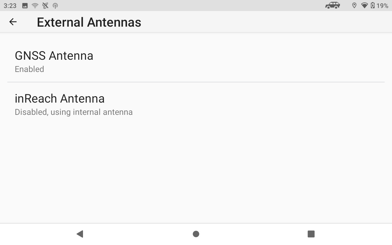

  7. The external antenna will now be disabled.
NOTE: This setting will have to be changed every time the device is reconnected to the dock.
