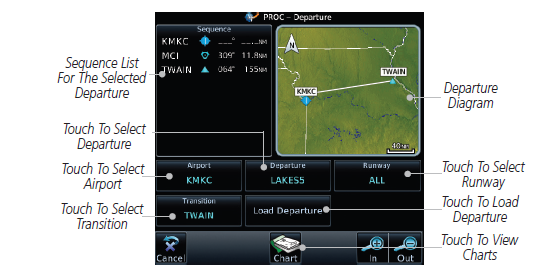

  1. Touch the PROC key on the Home page
  2. Departure 1
  3. Touch the Departure key to display the Departure list.
  4. Departure2
  5. If necessary, touch the Airport key and enter the departure airport.
  6. Departure3

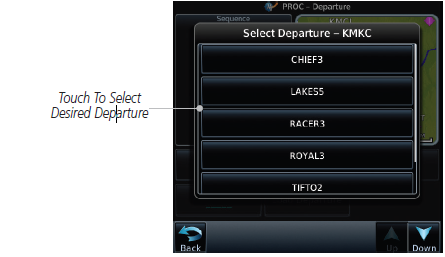

  7. Tap Departure and select a departure from the list.

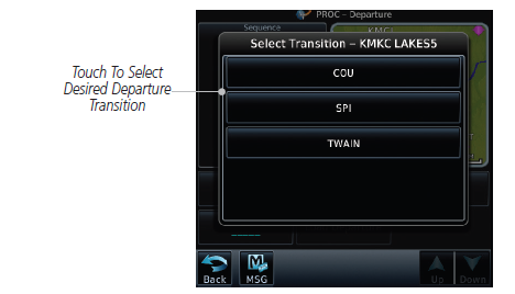

  8. Tap Transition and select a transition.
  9. Tap Runway and select a runway.
  10. Tap Preview, then review the departure diagram and sequence list.
  11. Tap Load Departure, then scroll the flight plan to view all departure waypoints.

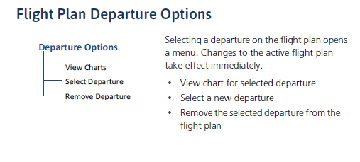

  12. To change the departure, tap the existing flight plan departure and select a different one.  If the selected runway displays a 'B', such as 'RW10B',  this means the selected runway is both 10L and 10R.
