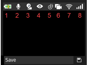

The following screenshot is an example of icons you may see on the status bar of Garmin Dash Cam™ 47 | Garmin Dash Cam™ 57 | Garmin Dash Cam™ 67W driving recorders.
See the meaning of each numbered icon below.
DC x7 Status Bar
  1. Battery Level
  2. Audio Recording
    • Audio off will show as a microphone with a line through it
  3. Travelapse is recording when this icon is displayed
  4. Dash cam is being remotely viewed
  5. Garmin Drive™ app connection is active when blue
    • Garmin Drive app is not connected or is remote when white
  6. Multiple Camera Network
    • Multiple dash cameras (up to four) are connected via the Garmin Drive app
  7. Wi-Fi network connection
  8. GPS signal
NOTE: A memory card low on space icon may also appear in the status bar Memory Card Low on Space
