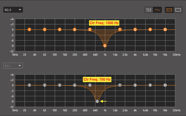

In Figure 1, you can clearly see the effect of adjusting only the "Center Frequency" of a filter. Both graphs show a single filter with a "Q" of 1.41, and a Gain cut of -9dB. The only difference is the "Center Frequency" value. The top graph indicates a Center Frequency of 1000 Hz for EQ Band #6. The bottom graph shows the effect of changing the Center Frequency downward, to 700 Hz. TuN™ allows you to select, for each EQ band, any "Center Frequency" value between 20 and 20,000 Hz.

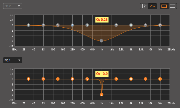

In Figure 2, you can clearly see the effect of adjusting only the "Q" of a filter. Both graphs show a single filter with a Center Frequency of 1000 Hz and a Gain cut of -9dB. The only difference is the "Q" value. The top graph shows the widest possible "Q": 0.26. The bottom graph shows the narrowest possible "Q": 10.0. TuN™ allows you to select any "Q" value between these extremes, giving you immense control over EQ correction.

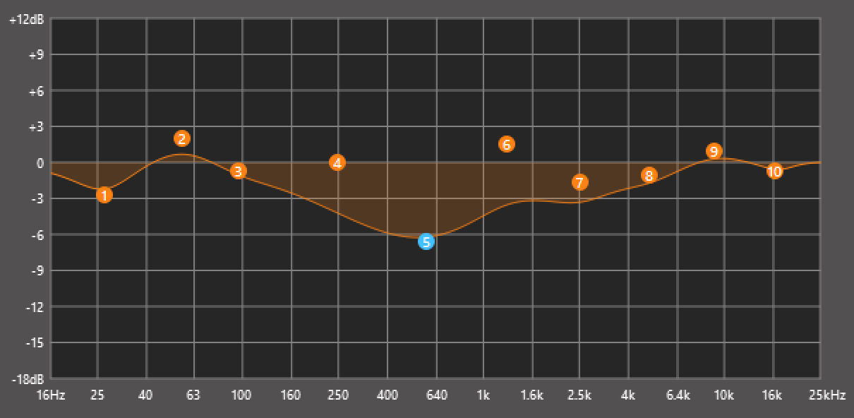

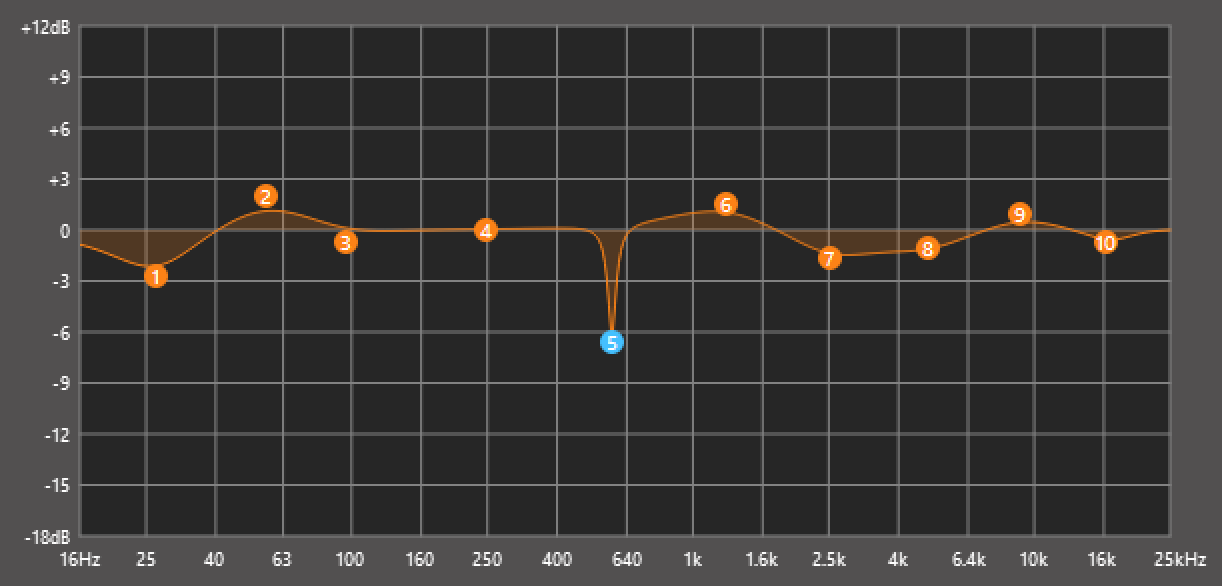

With a parametric EQ, it is possible to achieve highly complex frequency response curves using fewer filters than you would use with a graphic EQ. In practice, 10-bands of parametric equalization are just as powerful, if not more powerful, than 30 bands of graphic equalization. Here are two examples of complex curves, using multiple bands of parametric EQ.
Parametric EQ Figure 4 Image
Figure 3
Parametric EQ Figure 5 Image
Figure 4

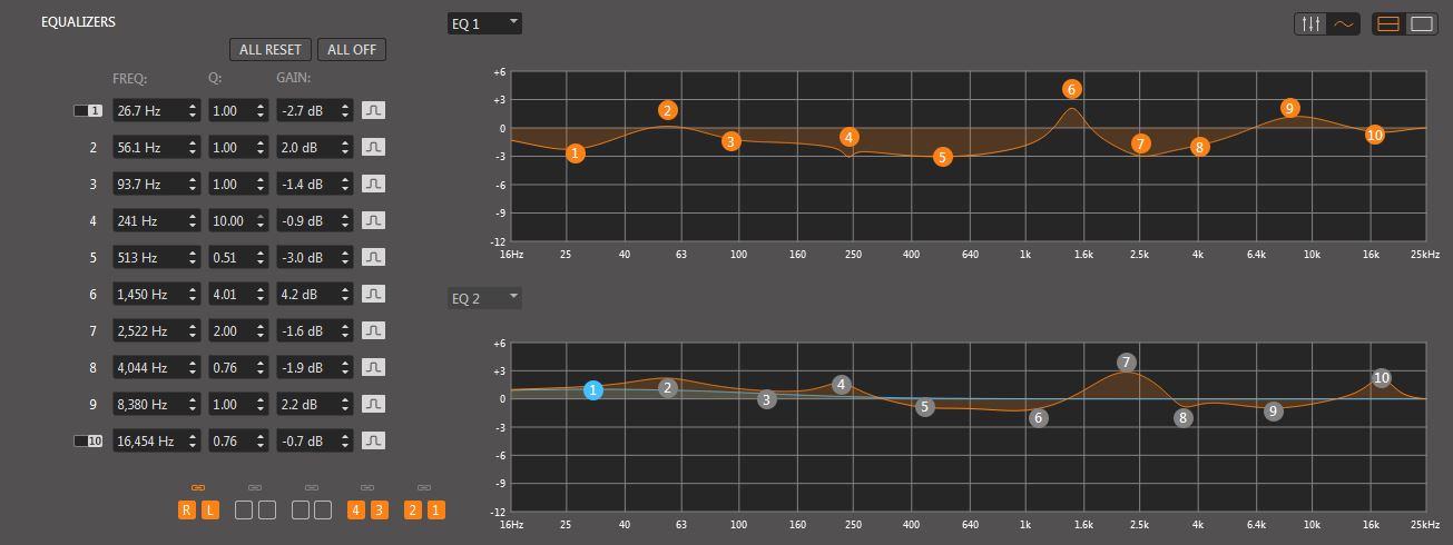

Manual EQ adjustment on the display graph: In Parametric EQ mode, the numbered, round EQ Band labels on the display graph can be directly selected and moved using the mouse/touchpad. The graph will display the resulting effect on frequency response in real time. The resulting value changes will also be reflected in the EQ numerical entry fields.
Manual commands:
  • Left Click and Hold, then Drag Up/Down for Boost/Cut
  • Left Click and Hold, then Drag Left/Right to change Center Frequency (Parametric EQ only)
  • Right Click and Hold, then Drag Up/Down or Left/Right to change “Q” (Parametric EQ only)
  • Control+Left Click to select multiple EQ bands. These can then be adjusted together.
EQ adjustment with Arrow Keys: You can also select EQ Band Label(s) with your mouse/trackpad, and then make adjustments using the arrow keys on your keyboard. Finer adjustments steps can be achieved by using the SHIFT key, in conjunction with the arrow keys.
