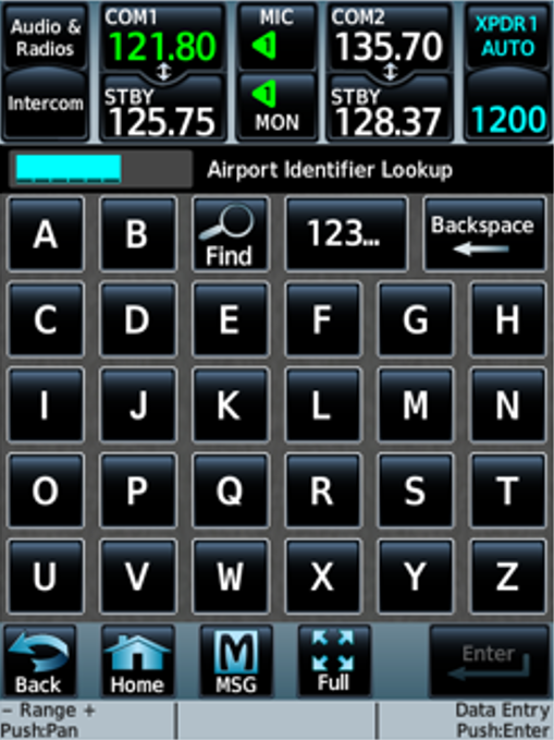

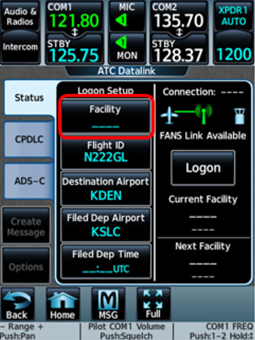

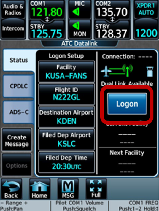

  1. Once in the ATC Datalink page, type KUSA into the ATC Facility Lookup field and press Enter.  Regardless of what tower or center the crew will be in communication with, the logon will always be done with KUSA.

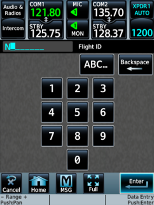

  2. Enter the Flight ID.  If there is not a Flight ID then enter the aircraft tail number.

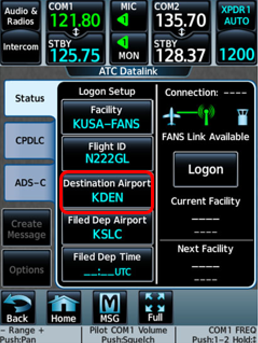

  3. If a flight plan has already been entered into the system then the "Destination Airport" field will auto populate.  Otherwise, enter your Destination Airport.  It is recommended to already have the flight plan entered (either on the flight plan page or by loading from the ACARS services page) as it will then auto populate the "Destination Airport" field.

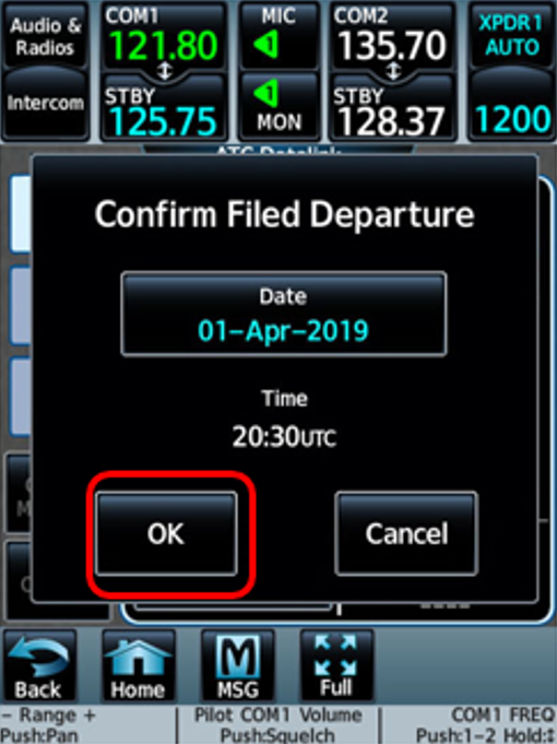

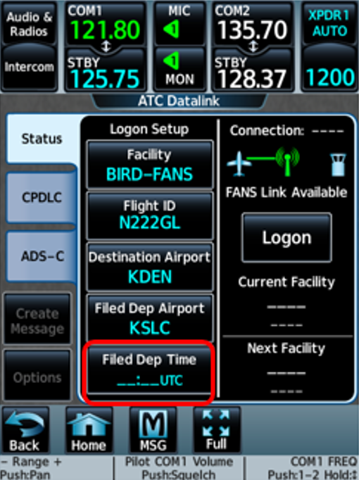

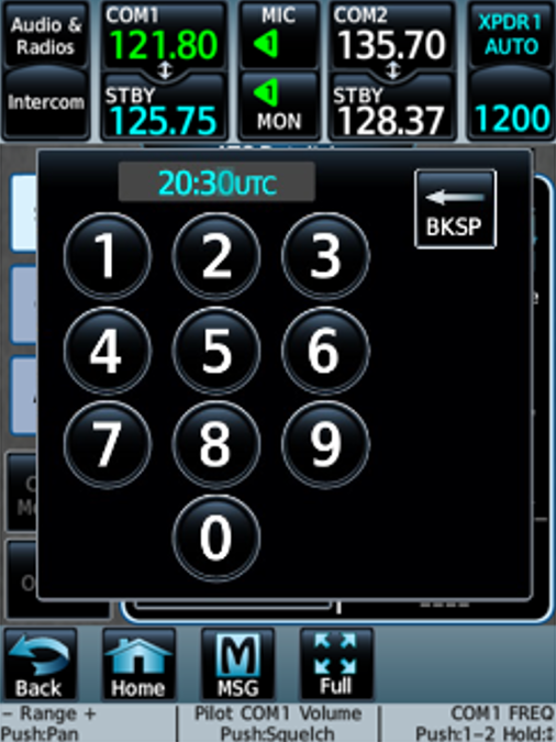

  4. If there are multiple flights in a day between the same departure and destination airports then a departure time is required.  Otherwise this field can be left blank.

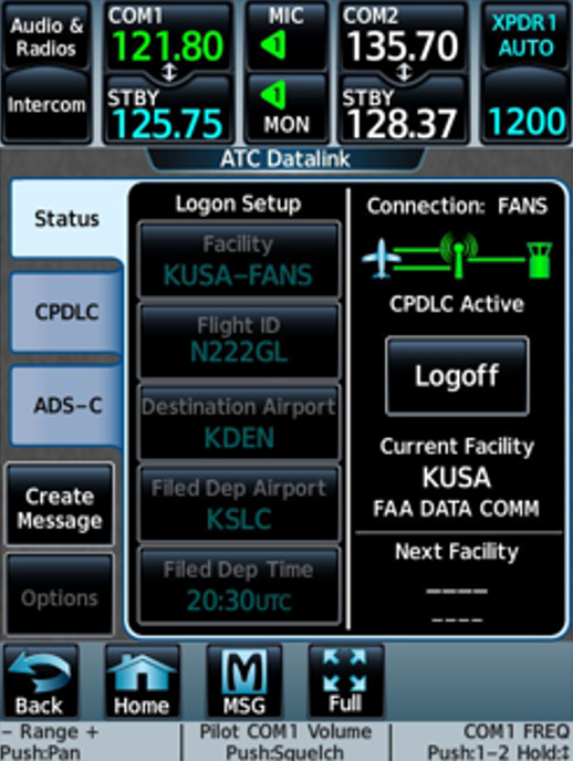

  5. Press Logon and verify you are connected.  The green line between the airplane and the ground station icon indicates the aircraft is communicating with the station but is not yet on the network.  A dashed line between the ground station and ATC indicates that a request has been sent.  Finally, the solid line and the info under "Current Facility" indicates that ATC has accepted the sign on and the aircraft is on the network.
