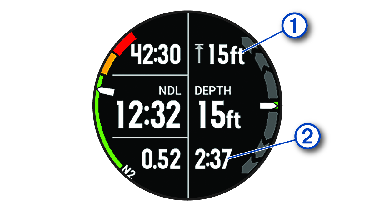

Viewing the Primary Gas Dive Data Screen
  1. During a single-gas or multi-gas dive, scroll to the first data screen.
    glyph icon
    Your nitrogen (N2) tissue load level.
     Green: 0 to 79% tissue load.
     Yellow: 80 to 99% tissue load.
     Red: 100% or greater tissue load.
    glyph icon
    Your rate of descent or ascent.
     Green: Good. Ascent is less than 7.9 m (26 ft.) per min.
     Yellow: Moderately high. Ascent is between 7.9 and 10.1 m (26 and 33 ft.) per min.
     Red: Too high. Ascent is greater than 10.1 m (33 ft.) per min.
    glyph icon
    Your partial pressure of oxygen (PO2) level.
  2. When you pass the no-decompression limit (NDL) time or perform a safety stop, the data screen shows ascent information.
    glyph icon
    The safety or decompression stop ceiling depth.
    glyph icon
    The safety or decompression stop time remaining.
