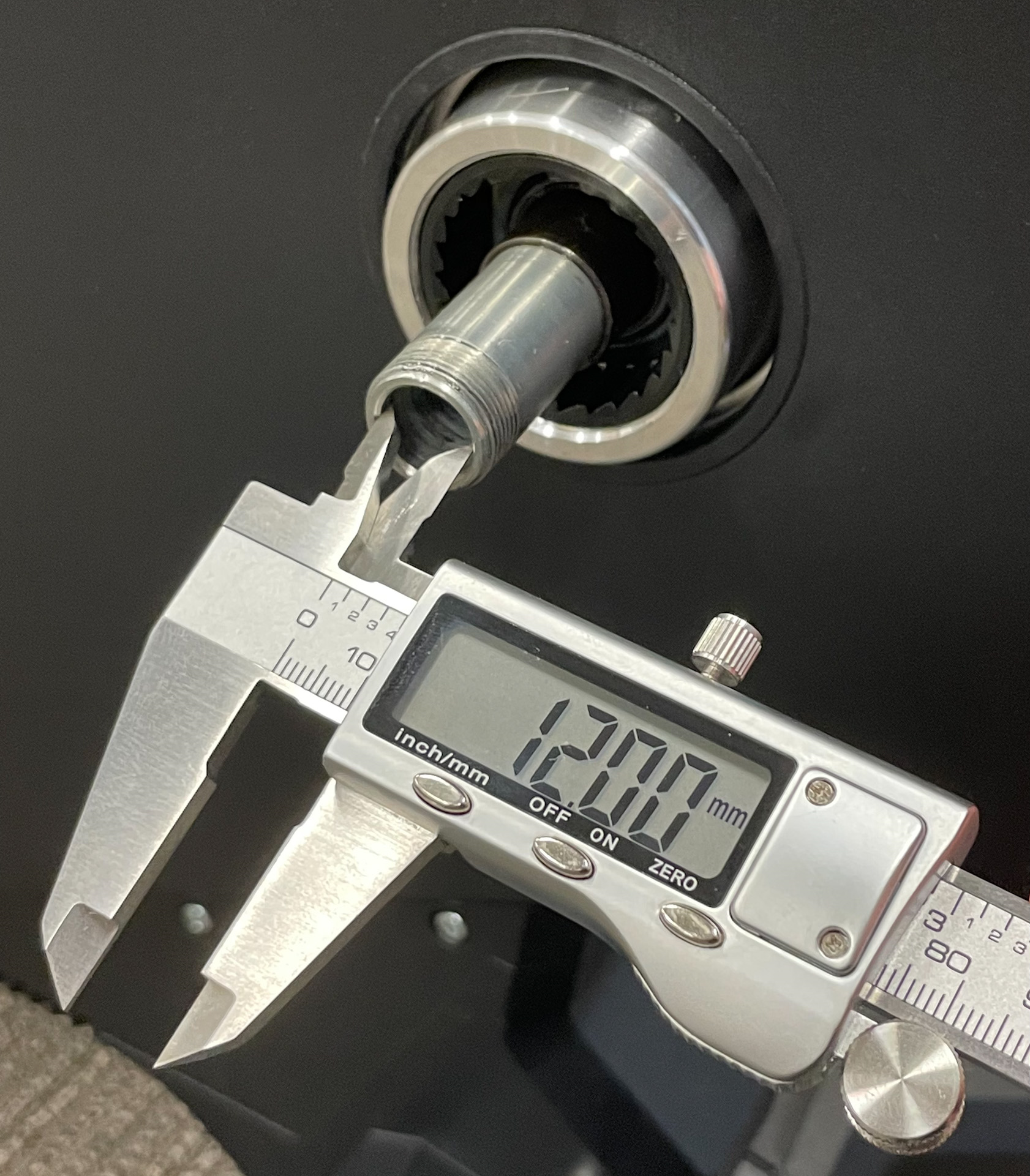

Measure the Inside Diameter of the Trainer Axle With the Cassette Body Removed Using a Caliper Tool
Calipers measuring Type 2 axle with 12mm readout
  • Type 1: 6mm or 9mm
  • Type 2: 12mm
