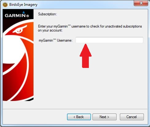

To activate the BirdsEye Subscription follow the instructions below:
1. Start the BaseCamp application, and connect the device to your computer.
    • The name of your device appears in the Library and Devices area.
2. Select BirdsEye > Download BirdsEye Imagery.
3.A BirdsEye Wizard box will appear, from the drop-down list, select the device to associate with the subscription or credits, and select Next.
4. Select an option:
    • To activate a subscription, select Where is my subscription?.
    • To activate credits, select Where is my credit?.
5. Enter your myGarmin™ login credentials, and select Next.
6. Select the BirdsEye product to activate, and select Activate.
The BirdsEye product is activated, and the subscription or credits are associated with the device. After activation is complete, you can download BirdsEye imagery. For instructions on that process go here.
